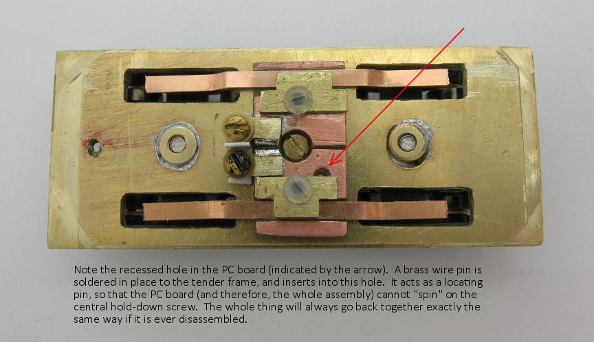

1. CNR552:
That M1.0 screw is indeed bridging across the split in that piece of PC board.  But that piece of PC board
(like all the PC board spacers) is only soldered to one side of the frame anyway.  As long as I chamfer back the copper
along the edges at the opposite end of it, where it touches the opposite frame half, it won't short across.
In fact, if I had thought about that initially, I would never have sliced through the copper on those PC board spacers at all.
There was no need to, and they would have been that much stronger.

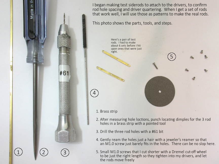

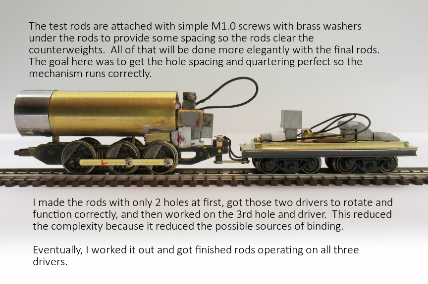

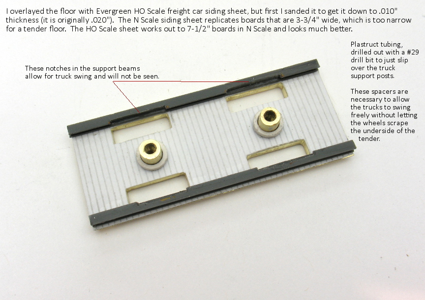

Hello everyone!

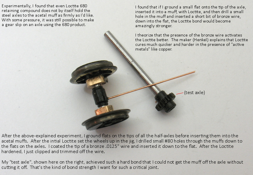

It has been a while, and there has been a huge amount of progress, so there are many photos in this installment.

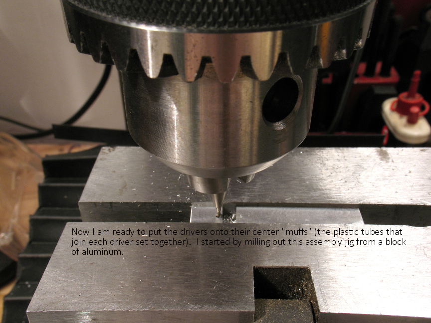

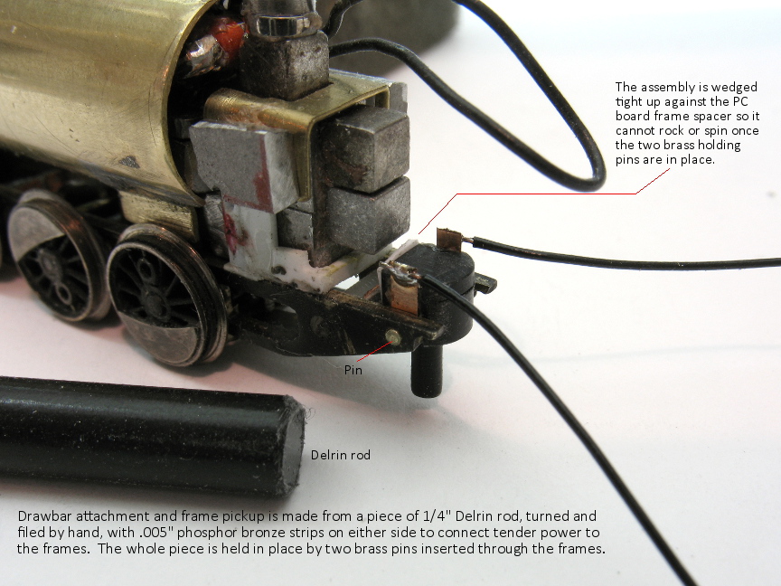

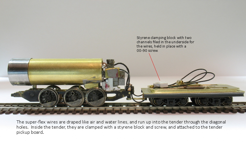

This segment covers:
Wiring / dropping voltage
Addition of weight

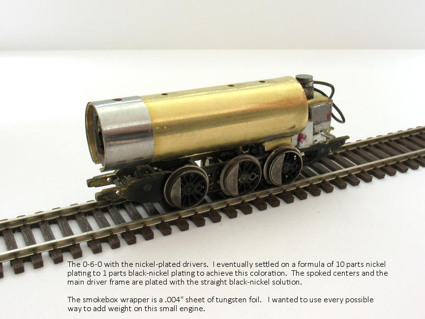

Driver installation and quartering

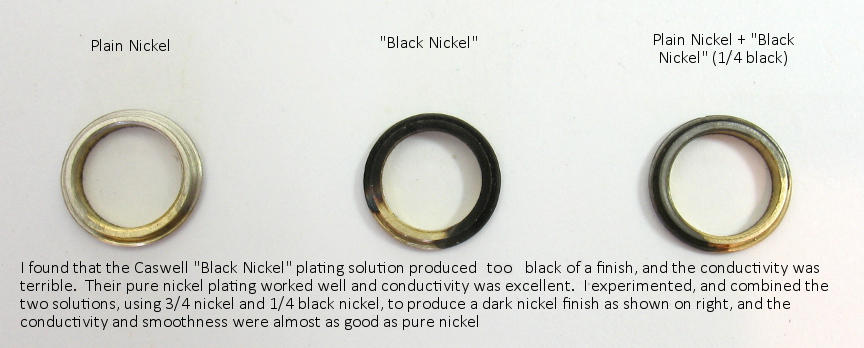

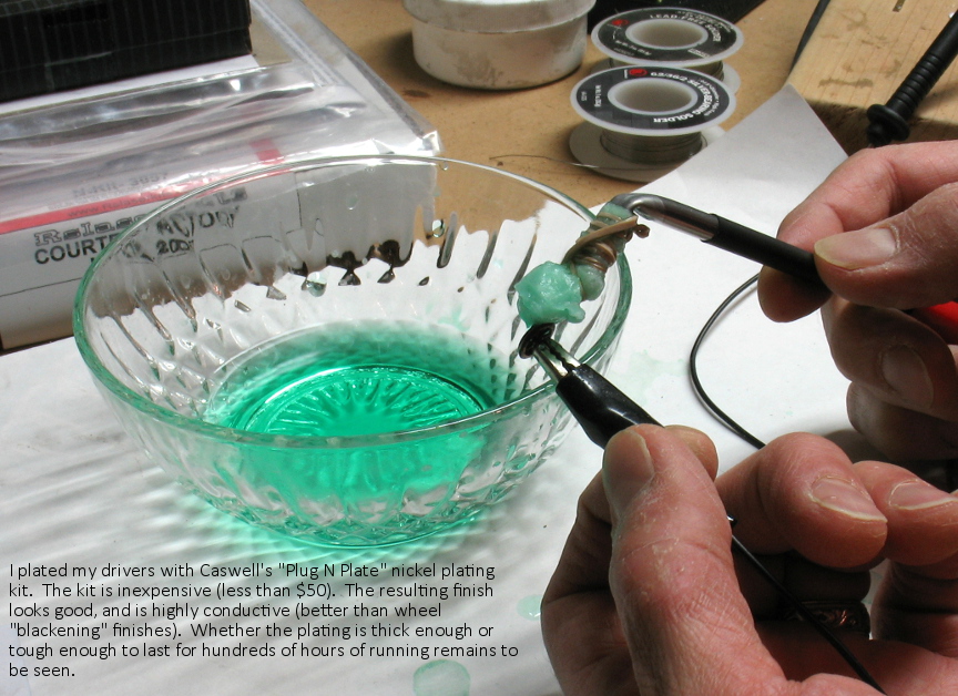

Nickel plating of the drivers

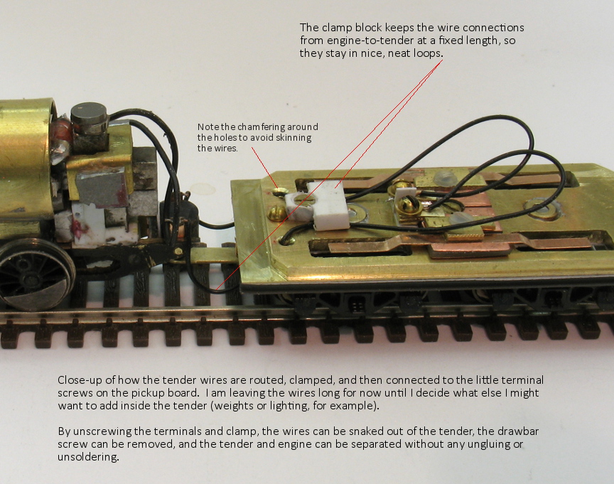

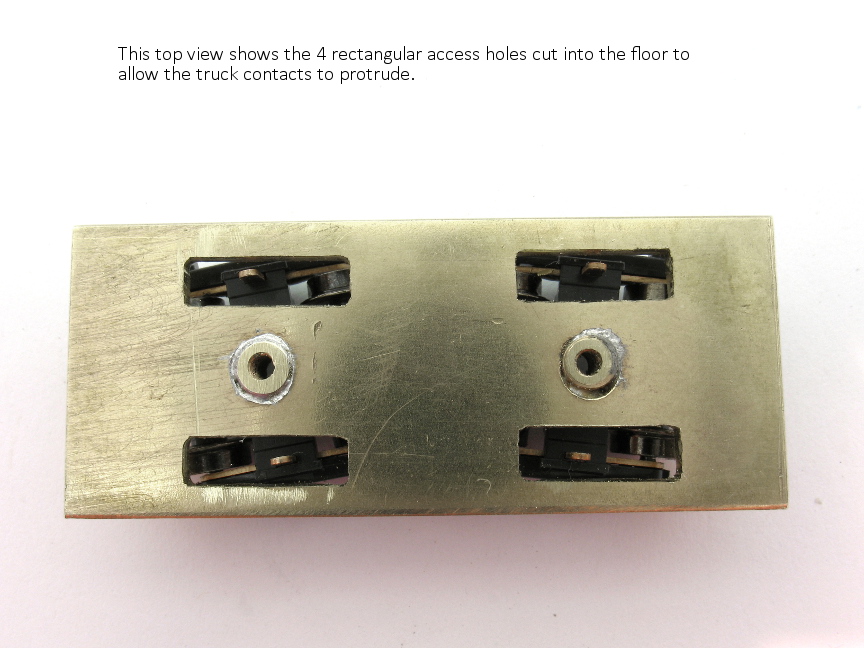

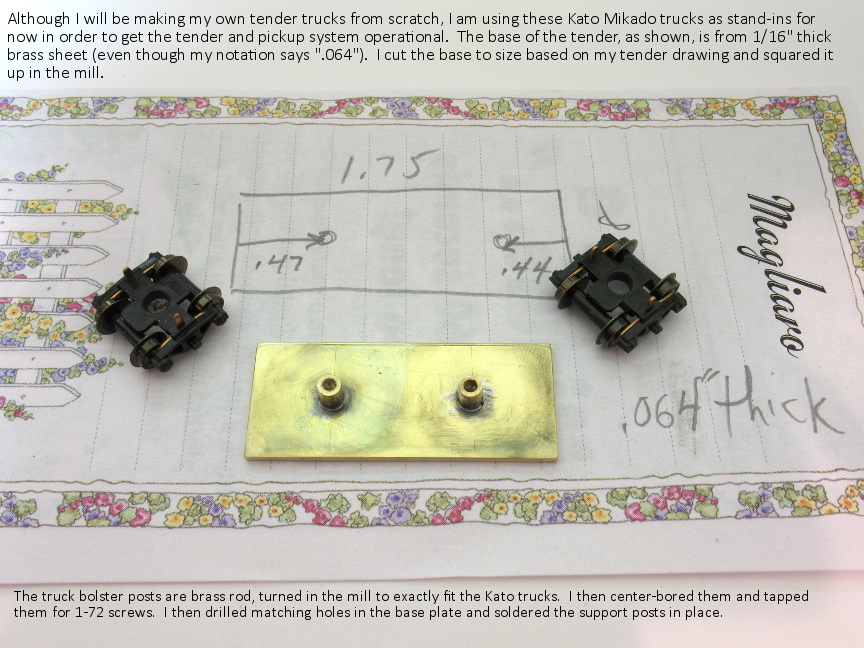

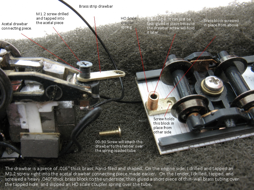

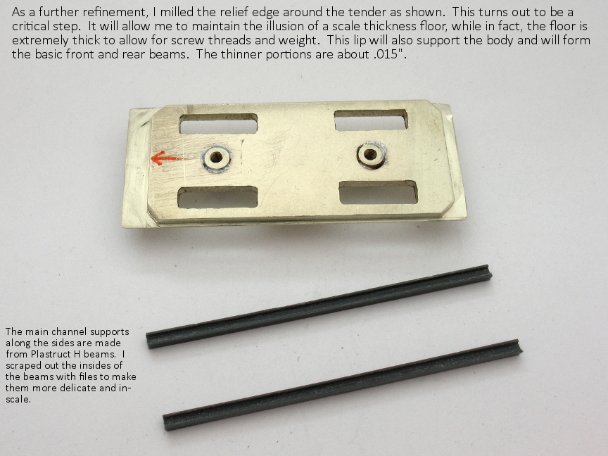

Tender frame, pickups and wiring
Working test siderods
Changed motor gear ratio
Testing
...and......
For the first time, some video of the engine actually in operation!

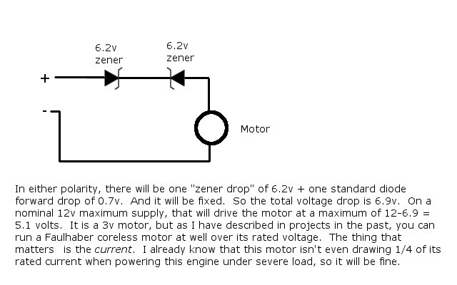

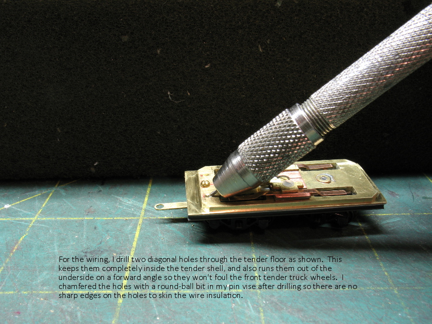

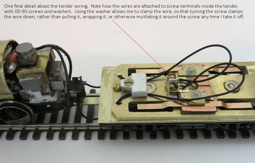

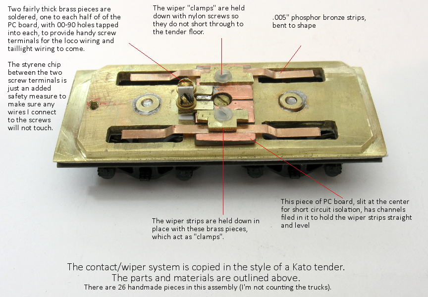

Wiring:
The basic circuit for limiting the motor voltage with zener diodes.  I am using a 3v Faulhaber motor.
Even though it can be driven well above its rated voltage with no problem, I thing 12v would pushing it,
not because it would burn, but because its RPMs would get so high that it could physically fly apart internally.
So I am limiting it to 5.1 volts as follows:

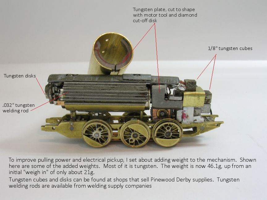

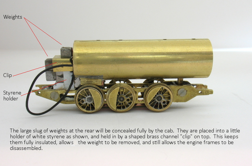

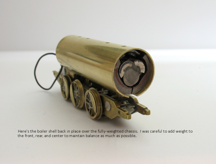

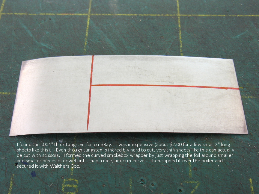

Weight
In this next shot showing my added weights, you can see the two zener diodes on the upper right just under the overhanging swath of thin tungsten rods.
(You'll see this wrapper on the engine in later photos...)

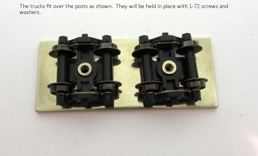

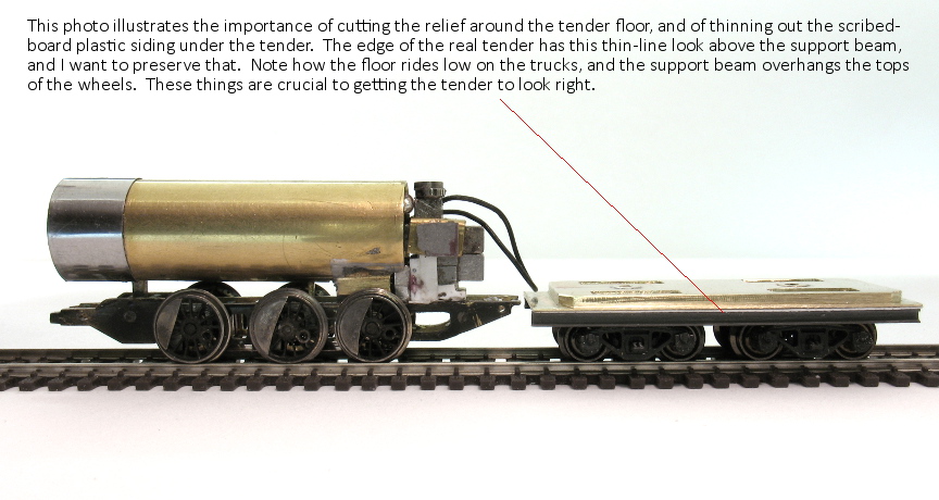

Tender Construction

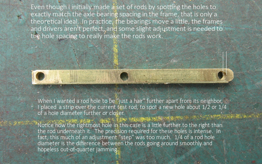

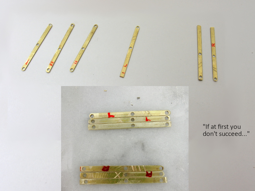

Working Test Side Rods

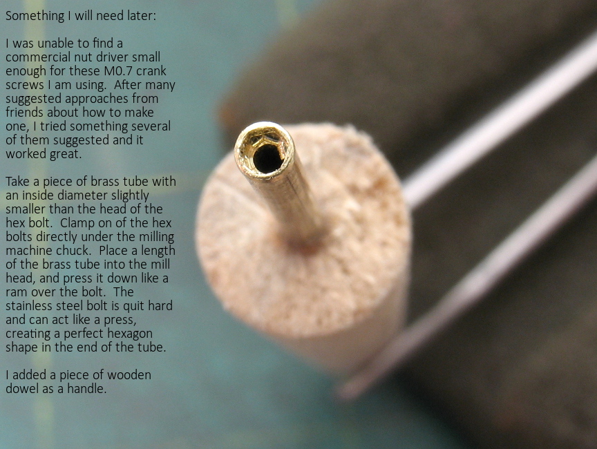

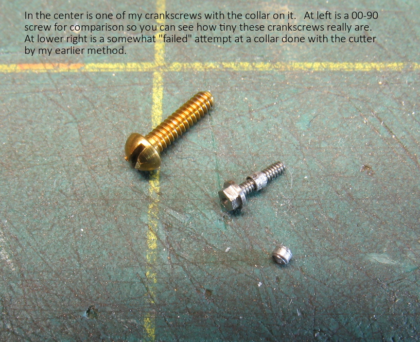

Future Smaller Crankpins (and the spacers needed for them)

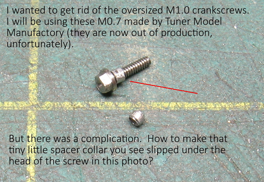

These little crank bolts won't appear on the engine until the next installment, but here's the prep work for them.

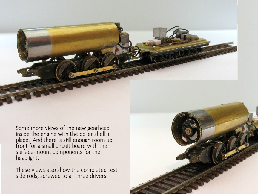

They will replace the big ugly Phillips Head screws I've got in there now.

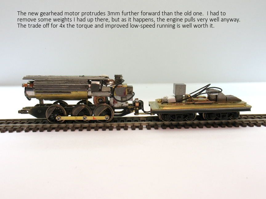

Gearhead Replacement (reduced speed, increased gear ratio)
And at last, after 18 months...
IT RUNS.
Video:

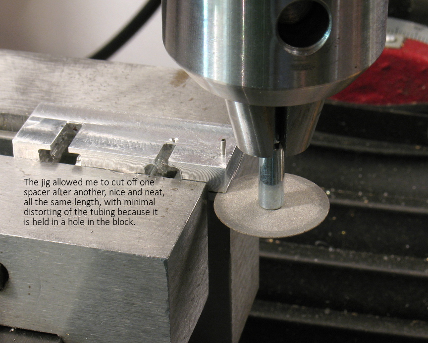

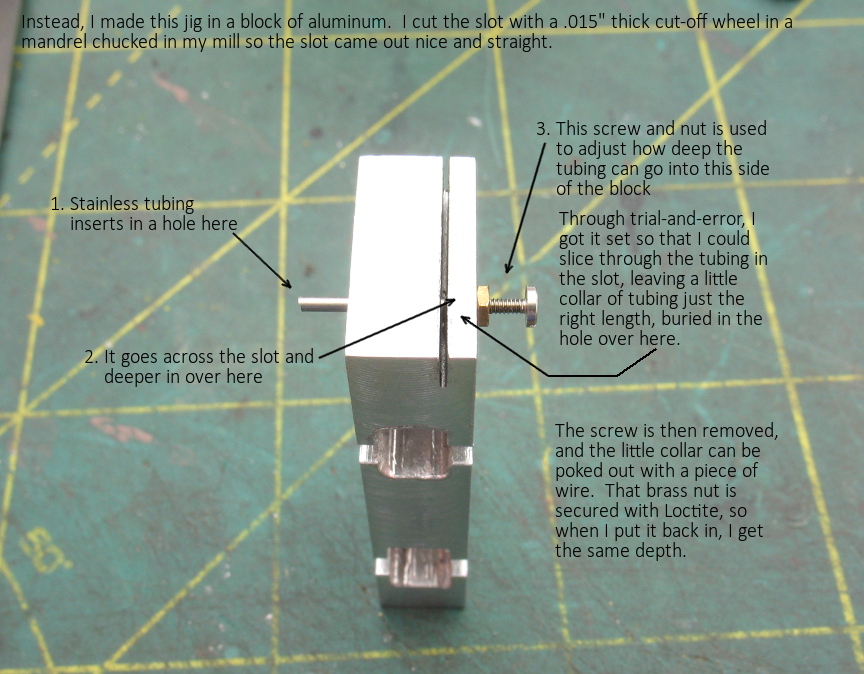

I also really your spacer cut-off jig.  That's one that you had a thread on and received... help(?) on.  ;)  But you got it anyway!
I've used and will be using a double jawed vise rig for cutting off lay shafts, pins, and such that has the same principle in play.  It's also a common device on manufactured cold cut-off saws.  The idea being that with both parts clamped there is no little tit left where the part breaks off at the end of cut which leaves a deburring nightmare if the part is otherwise finished, not getting that face cut in a lathe or mill.  Really sweet!  And it's in your same rig for the quartering so all special tools are together in the event you need another one some day.

Thanks, man!  Actually, I made the spacer-sawing jig in the same block as the wheel quartering jig because that block of aluminum was already sitting there on my workbench, and has already been faced on all 6 sides, so it's nice and square.  It just saves time if you can use another part of a nice neat square metal block instead of making another one.
I even cut a second quartering slot in that block, with aligning pin holes, to fit drivers on a brass Key/Samhongsa engine because somebody wanted me to cut traction tire grooves in it.  I needed to be able to get them back on their axles in proper quarter, so... why not?    It saved me time because that block is already machined to be the proper width between the drivers.
