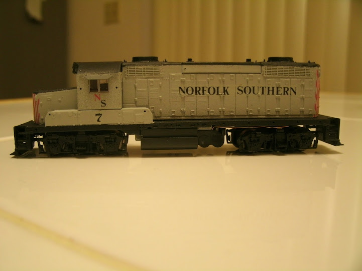

I apply decals without any of the traditional steps. This N-scale loco is sprayed with Rustoleum, brush painted with Polly S L&N gray and the decals applied directly. No gloss coat before, no dull coat after. You just need to be careful not to touch them when handling the equipment.
