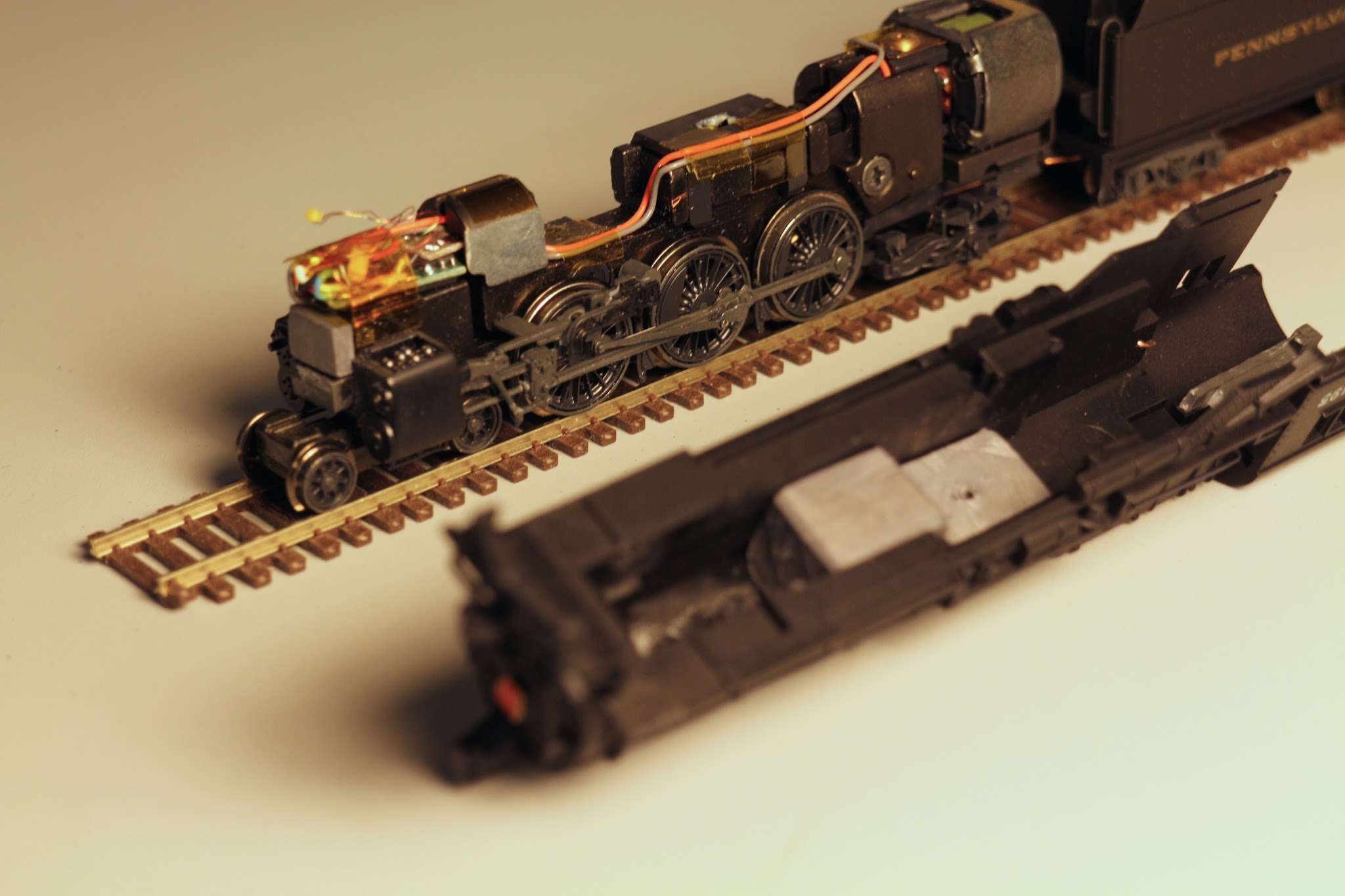

Completed a hybrid PRR K4.  Minitrix shell, Kato C55 chassis, Bachmann tender.  Credit goes to Ebit, who showed how to do this on the Atlas forum.  Still do not know Ebit's real name, so I was not able to thank him.
Is this prototypically accurate?  No.  Is it good enough for me?  Yes, until something better comes along.  Performance is smooth, even at very low speeds.
Added a little extra weight in the boiler.  Also squeezed a TCS Z2 decoder into the smokebox.  The decoder is programmed to reduce the top speed, which is well over 150mph without it.  The engine will easily pull 9 heavyweight cars on level grade.
