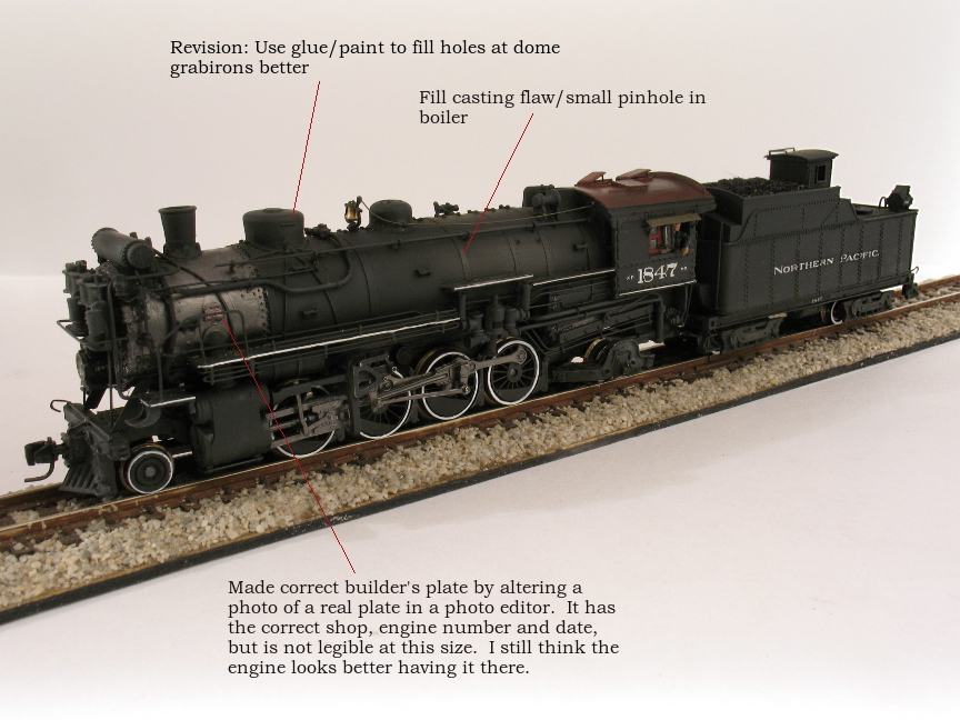

RE: the builders plate...does it really need to be fully legible?  It just needs to look like a builders plate, right?
It's kind of like a trust plate.  You know it's there and what it represents even if you can't necessarily read it.
It just completes the illusion.
« Last Edit: November 04, 2014, 11:31:31 PM by wazzou »

It would be cool if it actually had relief.  Etched brass would be fabulous, but even there, I don't know if you
could really etch out all that lettering at this tiny size.
I do agree that having an unreadable plate that just "looks right" is
better than none at all.  So I put one on.  See below...
This photo, I think, captures the color and tone of the smokebox a little better.   I tried to shift the lighting so I
could light up the side and undercarriage without blasting the smokebox.
« Last Edit: June 30, 2017, 05:30:43 AM by mmagliaro »

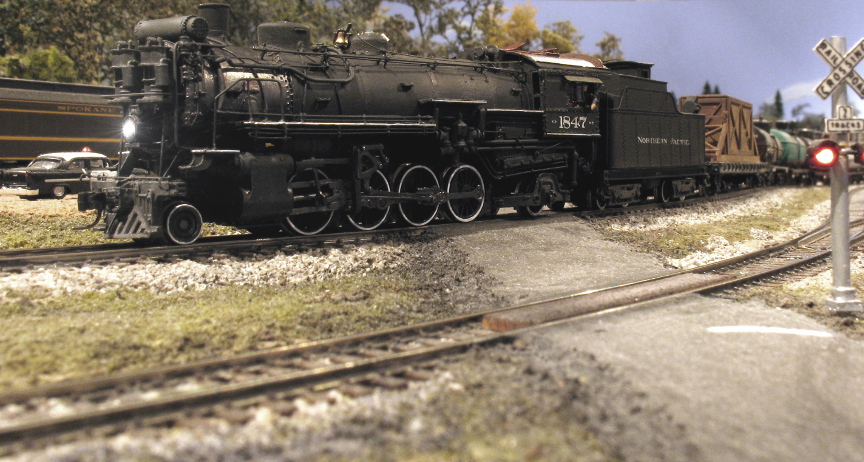

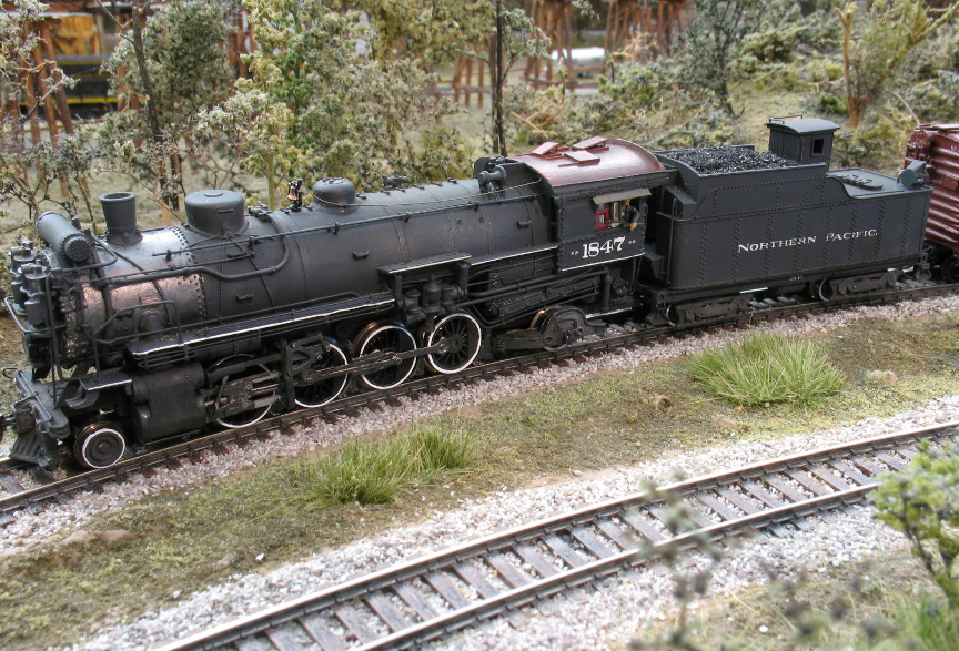

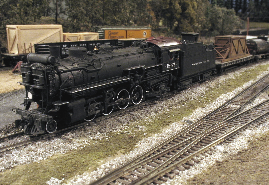

Here are some "on the layout" shots.  Yes, I do actually run it!
(In the interest of full disclosure, the headlight is photoshopped...)
« Last Edit: June 30, 2017, 05:32:01 AM by mmagliaro »
