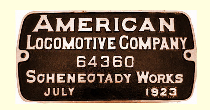

And if anyone knows of a good way to make an N Scale Alco builder's plate, I am all ears.
I found some on-line, and photoshopped them to have the correct builder's number, shop,
and date on it.  But it is only a scale 14" x 7", so no way can I print text that small with any clarity.
I don't think anyone makes builder's plate decals.
It has to look like this, and be 14" wide by 7" high

I can shrink cast the builders plate.

Jason,
Do you really think you can shrink cast a builders plate?    That thing in N Scale is only .0875" wide, and the raised letters,
yikes, they are as small as the tiniest lettering on a Microscale decal sheet.   I would have to find you a large one
with all the relief  in the letters, right?   I know Precision Scale and some other companies make these for
HO and O Scale.  I will see if I can find one that is close, and then alter the date and engine number with tiny
bits of styrene or something so you'd have something to cast.  This really sounds like a promising idea.
Thank you for the offer!

No doubt, you will be able to read all the letters and numbers..... "With a magnifying glass"

I could print the builders plate decal in black/gold on Alps.  Easier and faster than shrink casting.  :D  I helped Ron Bearden out, I can help you too.   ;)
But I think that at 600 dpi some of the smaller lettering might not be legible.  I could try and see.
