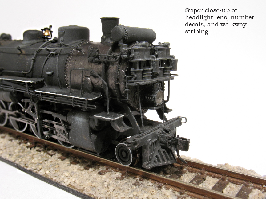

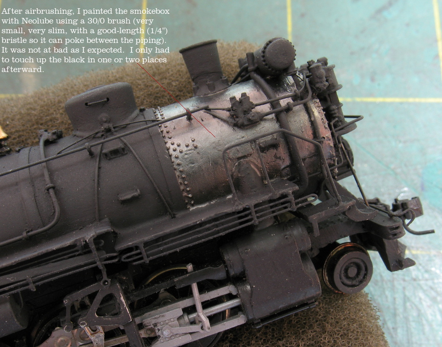

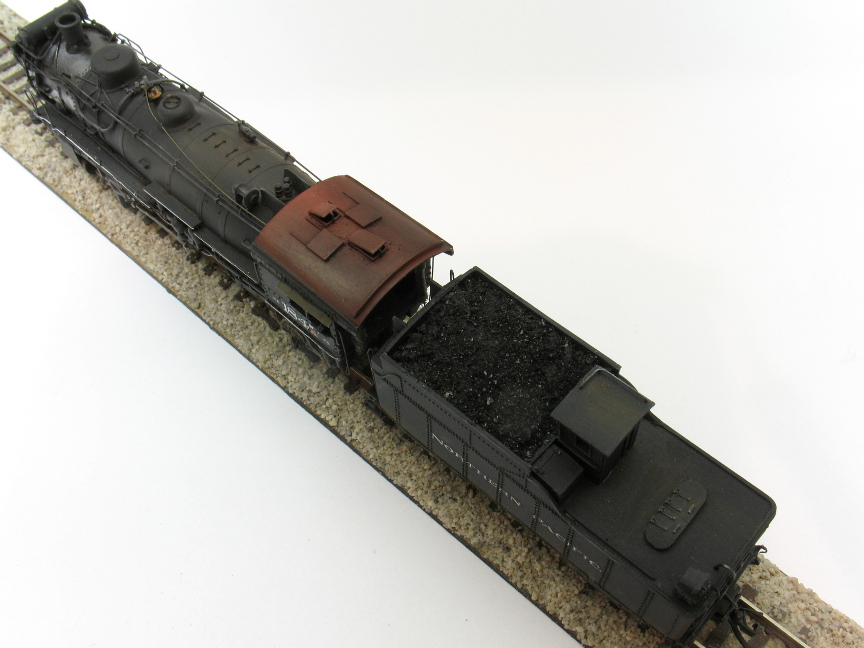

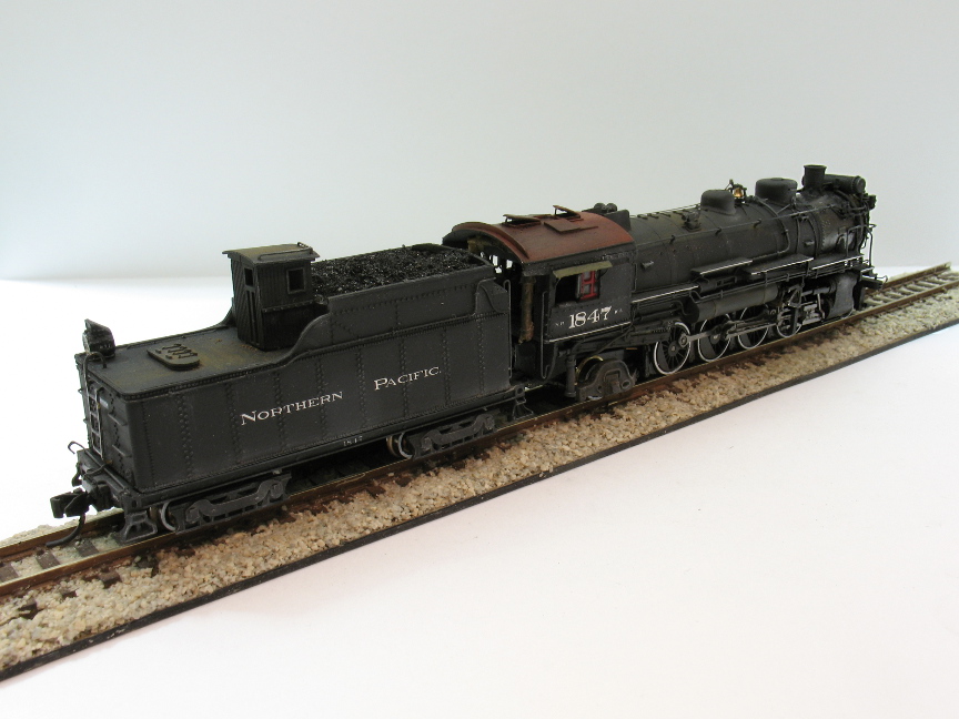

« Reply #107 on: November 04, 2014, 06:42:02 AM »
Hi everybody.

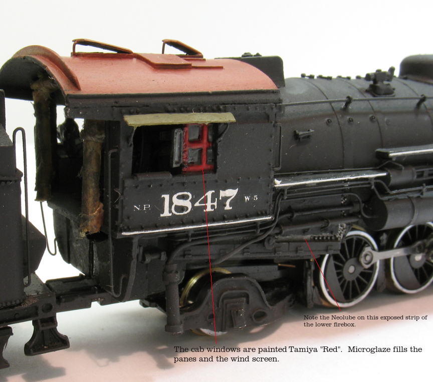

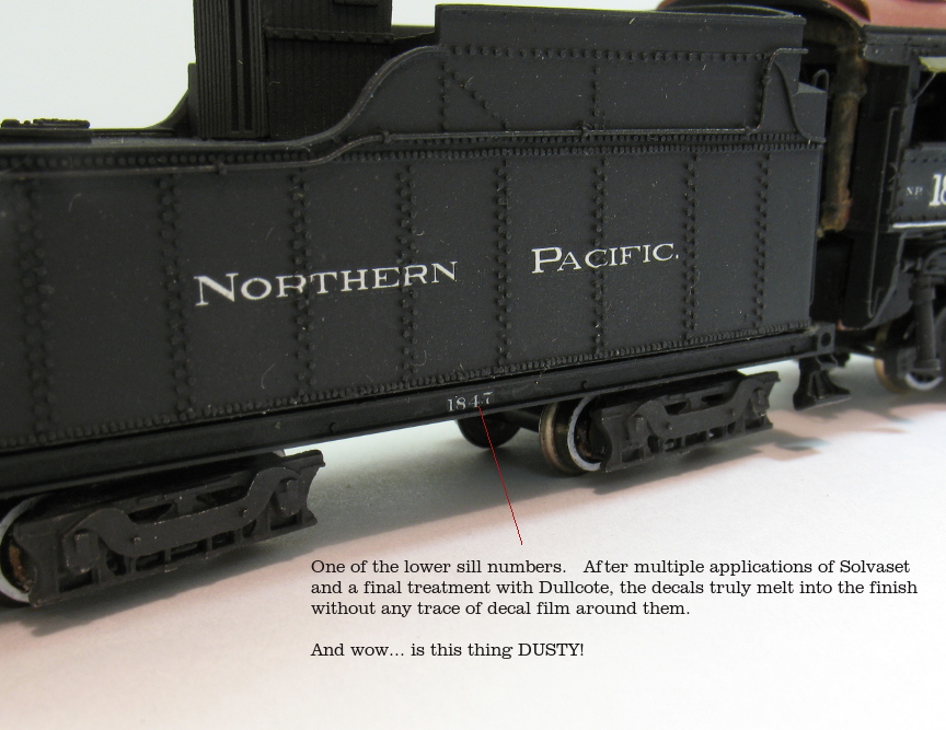

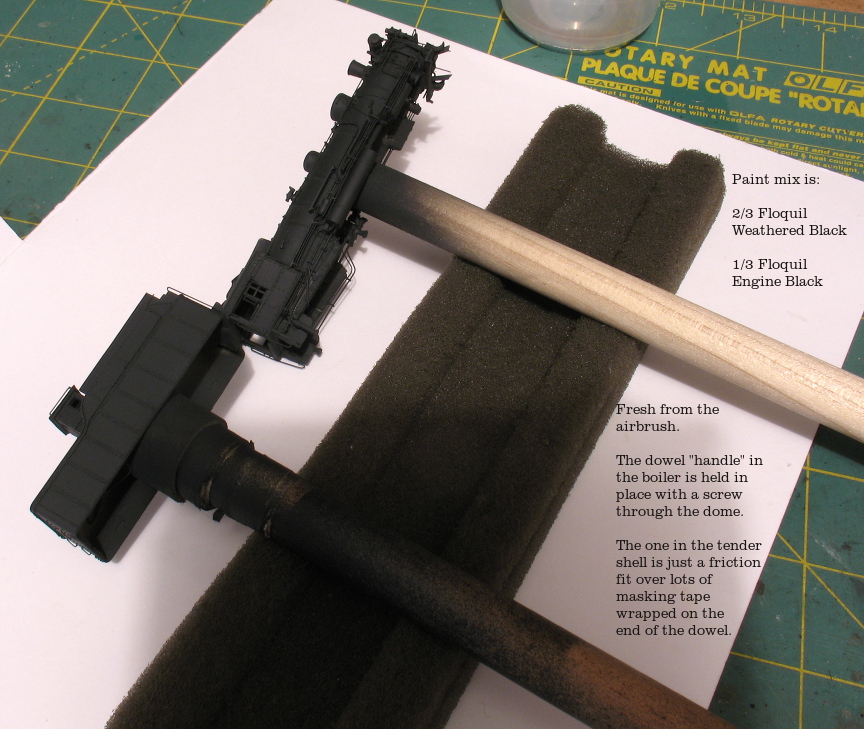

This installment includes painting, the backhead, and final exterior weathering and detailing.
It's finally done!

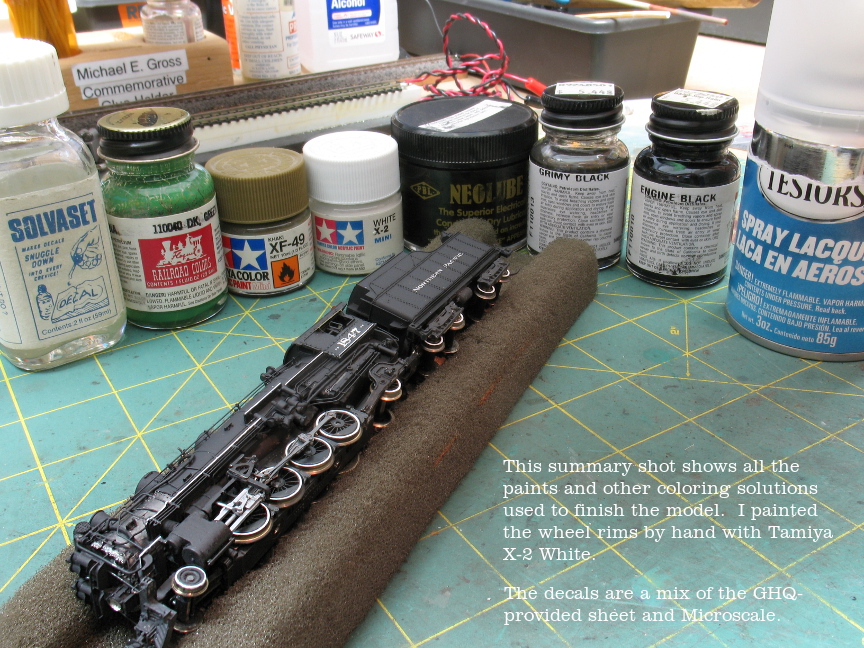

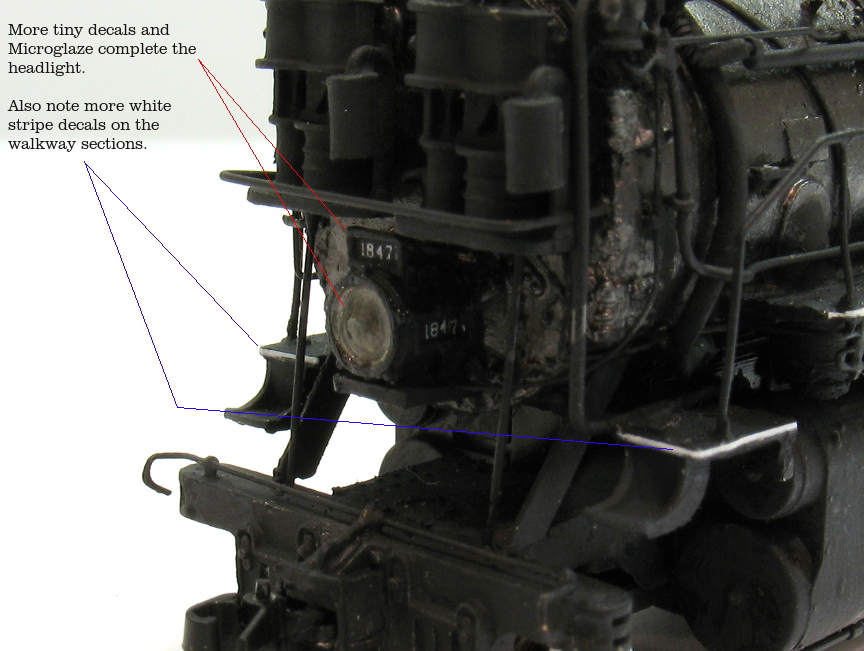

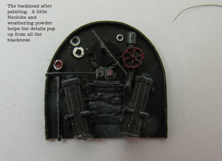

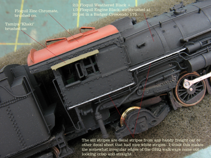

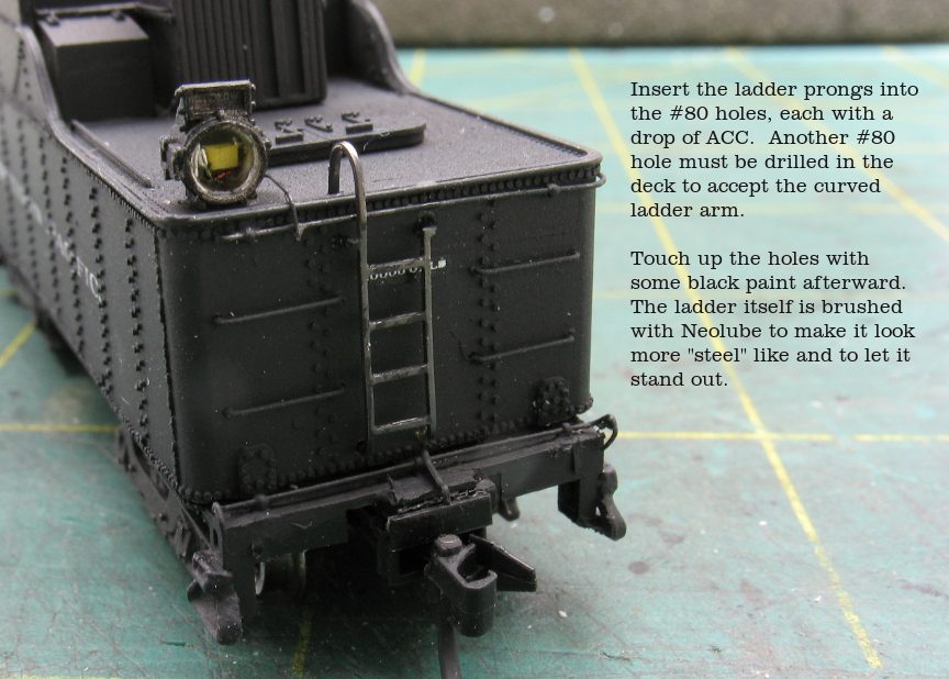

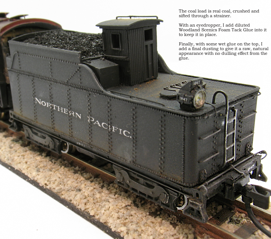

First, here's a shot of the initial airbrush job on the loco and tender bodies:

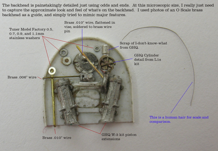

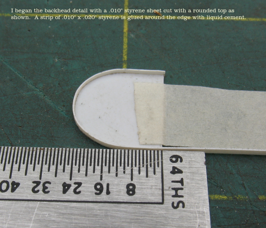

Now, the backhead

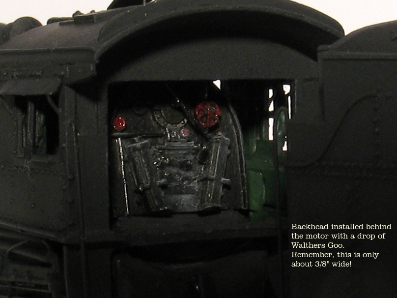

Thanks to alert reader Jason (superturbine), I did note that there was indeed enough room to model a backhead in this engine.

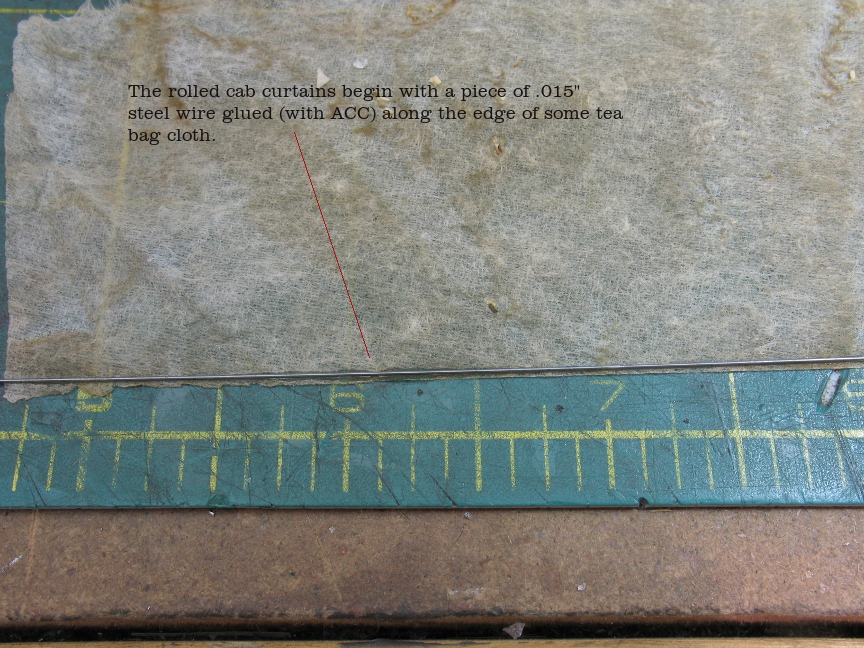

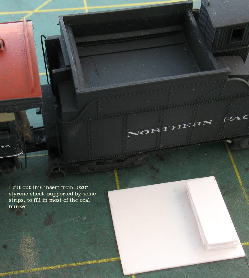

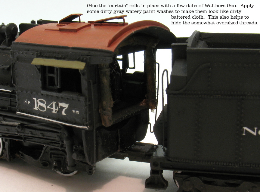

The original Kato Mikado backhead part was too thick and bulky to fit.  So I decided to just make one, and model
the cab curtains rolled up and open so it would show.  I copied as much backhead detail as I could
from photos of a brass O Scale W-5.

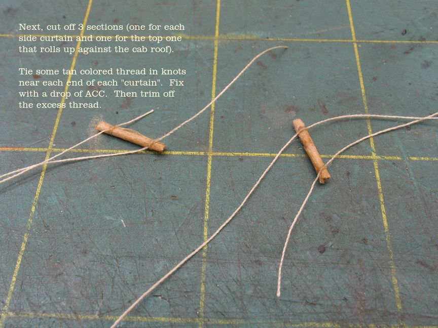

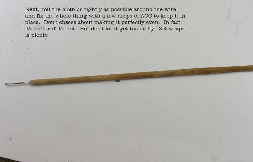

It is also a good idea to mash the curtain "rolls" at this point with some tweezers or needlenose pliers so that they
don't stay perfectly round.

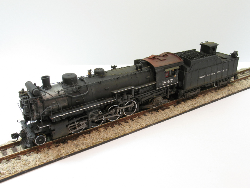

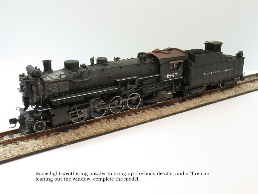

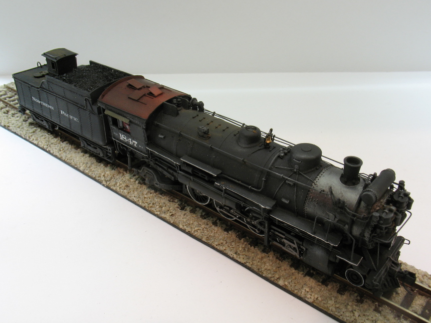

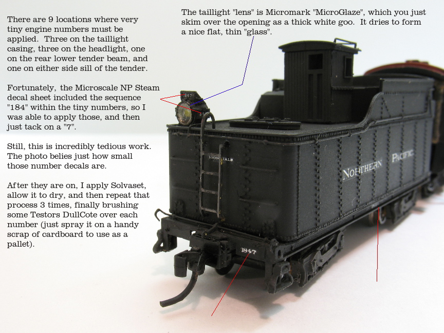

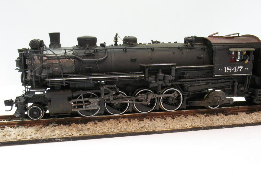

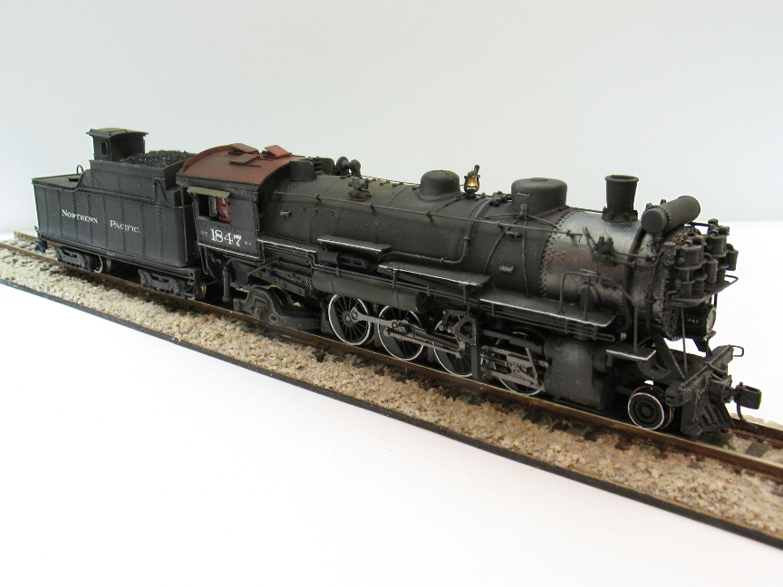

And that's it!  The following is a set of photos of the finished model.
My most sincere thanks to everyone on Railwire who encouraged me and shared
in this project.   :)

I really do love how it turned out.   I didn't weather it heavily, because it was just too darn pretty.  So we can
pretend it was recently shopped and washed.
Andrew, your work on Greg's W-5 years ago was really the thing that put this project into my head as something I wanted to do.
Now I just have to patch up that little pinhole in the boiler on the fireman's side above the Elesco pump.  Ha!  Ha!
I was somehow blind to that until I saw it in the photo.  Luckily, it will not be hard to patch up.
