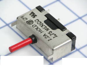

I attended to the breaker/overcurrent device on my layout.  For years, I just used one of those
little silver metal rectangular breakers with the red "stick" sticking out of one side made by Littlefuse.
They look like this:
It works, but it isn't the greatest for protection.  There's a good bit of delay, and these little breakers have a wide
range of hold/trip behavior.    So, I started entertaining thoughts of building a crowbar circuit
 that would simply open a relay to shut off the power.
Those can be extremely accurate and fast-acting.

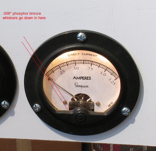

But then I went back to my dinosaur days and realized that the cool old-fashioned Simpson panel meter
I use to monitor track current could provide the very trigger I need.
In fact, a panel meter is doing just what a crowbar circuit needs: It is creating a tiny voltage drop across a sampling
resistor (a coil, in the case of the meter).
So I opened it up and fashioned two very fine phosphor bronze wires as a switch.  They sit down inside the meter, positioned
so that when the meter is pegged at full-scale, one wire touches the other.  They have to be very fine "whiskers", because
the meter movement does not have a lot of mechanical force.  I used .006 PB wire.

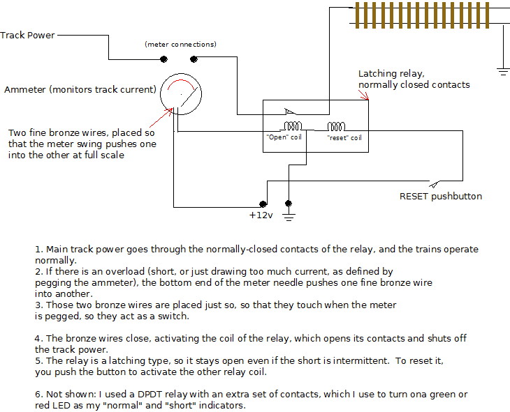

I hooked that little "pair of wires" switch up to a simple relay trip circuit.  So it's a "mechanical crowbar".  It trips *exactly*
where I want it to, at the meter's full scale, and it trips immediately.  No heat issues, no delays.
It works amazingly well.  It won't shut off on an "instantaneous short", but darn near.  The only time delay is the time it
takes that meter to swing to full scale, which ain't much.
Here's a diagram of how it works.
