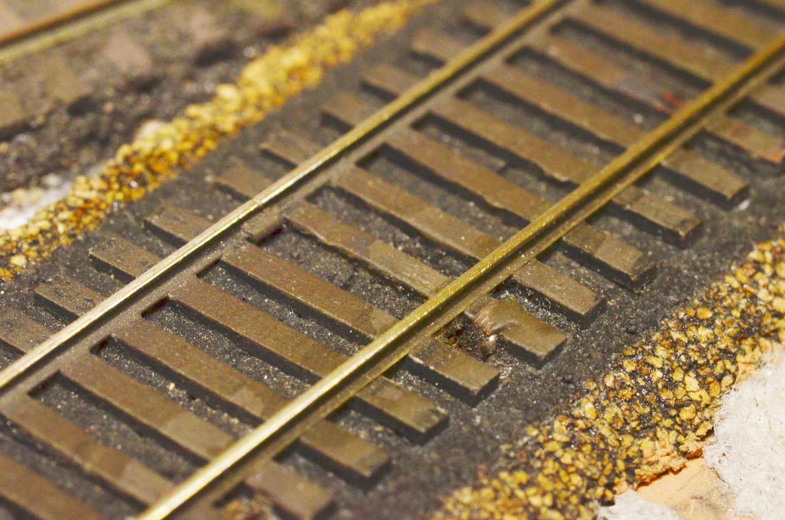

I've been using ME flex since the early '80's when it was known as Rail Craft, and it's always been more difficult to curve and get straight, but its appearance is exponentially better than either Peco 55 or any code 80 flex.  It's also noticeably better looking than Atlas 55 in the "spikehead" dept, but the "wooden" tied version's ties are not as square as Atlas's ties and are slightly longer, imitating class 1, heavily trafficked tie specifications.  They also have more relief and sometimes rounded ends on a few ties.  If you're going to use any wooden-tied ME, just run a sanding block with 220 grit emery cloth attached over the tie ends for a quick solution to that cosmetic problem.
Since the track is a whole lot stiffer than Atlas floppy flex, the rail joiners are less necessary, and some modelers here are laying their ME concrete-tied flex without any rail joiners by staggering the rails at the joints and just inserting the protruding section of rail into the new flex piece which has had a corresponding length of track removed.  If you insist on rail joiners, I cut my ME railjoiners into thirds so they're slightly less than the length of the space between ties (hafta cut them while they're mounted on a scrap piece of rail so's not to crush 'em).  I also cut off the "tongue" which protrudes on the bottom of the rail joiner on either end and is useless IMO, just making the joiner longer.
I cut the spacers between ties for three ties on either side of where you're going to put the joiner and slide them back, stick the joiner on, solder it, then slide the ties back into place.  The short joiner becomes virtually invisible when you do this, and you double the amount of joiners you've bought too.
Here are some photos of joining up ME flex (actually Rail Craft 55) using the shortened joiners:
Here's photo of a short rail joiner on the top rail and a PCB feeder on the bottom rail.  Hand-laid code 40.  Sorry couldn't find a photo of painted-weathered-ballasted code 55 with a visible short rail joiner.  As you can see, they virtually disappear:
Since both ME rails are tightly clamped into place by their respective "spikeheads" (no loose rail), you gotta get both rails cut just right for the joint to be smoothly contiguous.  If you want the joints to be in a particular spot, like between ties, then you need to have both pieces of flex mostly bent at the time you join 'em up.  You can still do minor flexing to get the kinks out, but have them almost smooth or straight when you join them, either without joiners, or with soldered joiners.
