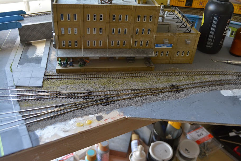

Started my first ballasting... it's turning out ok and I didn't ruin the turnouts.  Just ran a train over and all I had to do was scrape out a little loose ballast and polish up my points a little.
I really want to go nuts with tufts and grass and make the scene really nice but it's something I don't have a lot of experience doing.

Doesn't look too bad from here. just be sure to get any loose pieces off of the tops of the ties and off the web of the rail. Once done, it really makes a difference.

Yeah I've been going over it with my little dental scraper thing.

My $.02... try to knock down some of the humps at the top of the ballasted area. Unless you are going for a freshly ballasted look, chances are vibrations (in real life) would level them out pretty quickly.

Yeah it's a bit humpy in areas I did touch-ups on.  I can probably scrape/sand it down a bit and hide with weeds.

Instead of scraping dry ballast, which won't likely smooth out nicely, try rewetting the area and doing a light tamping.

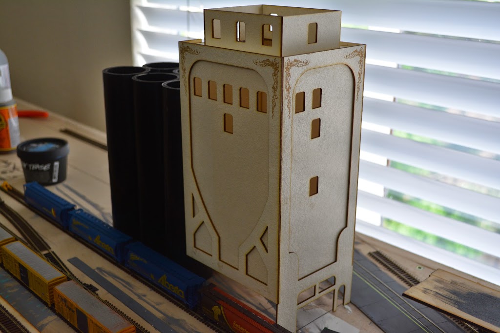

Started work on a boring old run of the mill grain elevator with PVC pipe silos.

looking really good
thanks for sharing
I'm liking your elevator and the way the building has some unusual shpaes. would like to see more when you progress. Overall, like several features you've included and enjoying watching your progress. Good job on the static grass also. I'd second looking at the DKS layout if you're wantng to see some grass in the tracks. He's a magician when it come to realism.
