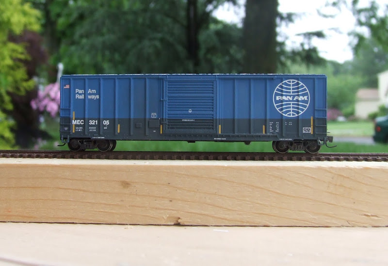

lowered FVM FMC 5357 boxcar (BLMA trucks) + z couplers.
