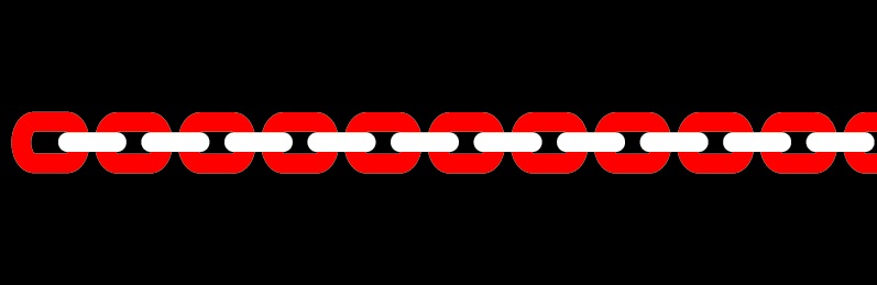

Expect an 3D etched 88LPI stainless chain 1Q 2013. Here is how it will look.
Links are .018in high by .0088in long and .005in thick.
That's a great news Bob!  That should be a great looking chain!
I was wondering why the other photoetched chain you were selling (the one in my photo) wasn't really made to look like a 3D chain.  It was flat and looked more like flat loops connected together.
