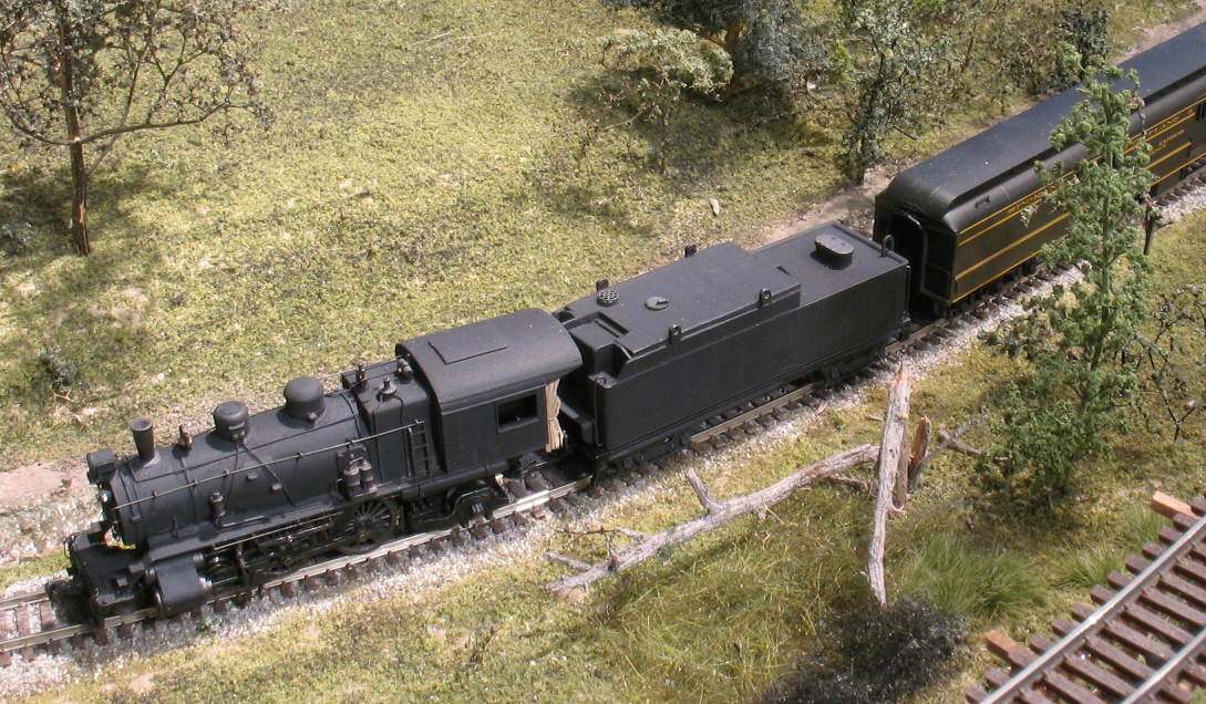

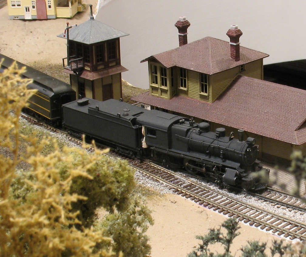

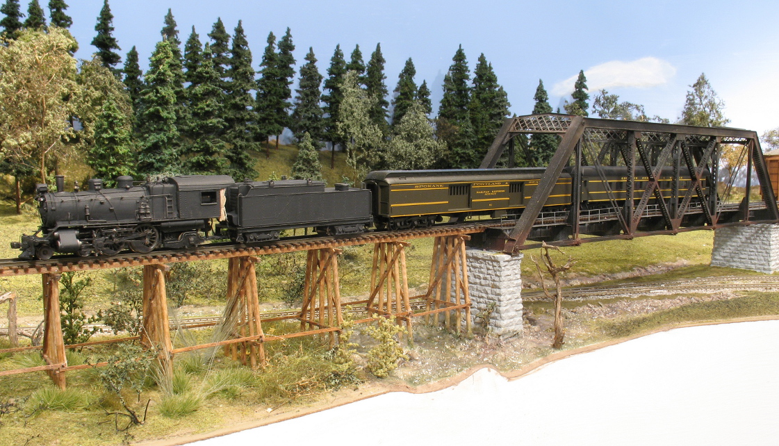

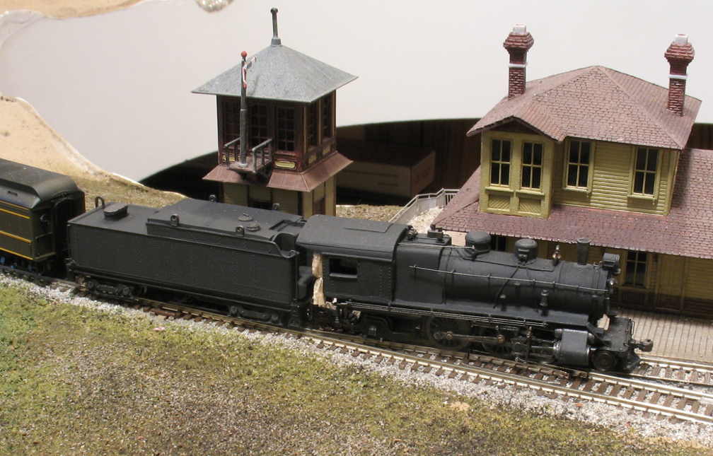

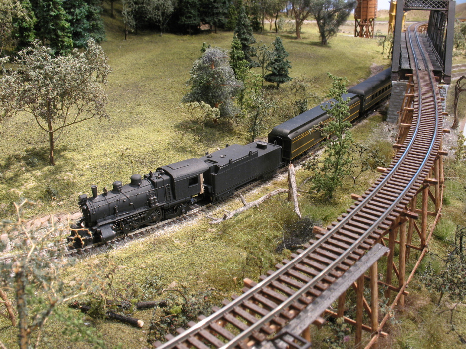

SP&S #604 is painted!
(Click the photos to see them full size)
Here it is in a variety of scenes, running around the layout.  Paint is 2/3 Floquil Weathered Black, 1/3 Floquil Engine Black.  I want to add some cab shades, and weather it with a little light gray and white powders which will make the details pop, but first, I'm working on decals.  I need the Spokane Portland & Seattle Ry  oval with the wide band around it that contains the words "The North Bank Road" and "Columbia River Scenic Route".
It needs to be gold, and I will need the cab numbers and the tiny "SP&S" for the dome to match.
I have been working on an art drawing to get them custom-made, but I may also have a source.  Stay Tuned on that one.
All the appliances and the railings and most pipes are painted with NeoLube.  It's the perfect thing to give them the subtle appearance of metal, and makes them stand out from the black body.   I am not sure about the smokebox and lower firebox area.  I used to use Neolube on those all the time, but photos of this engine aren't making it clear if they really had that graphite gray look to them or not.
By the way, those two passenger cars are custom-painted Lowell Smith Signature Series SP&S.  He's done just the baggage and the #99 business car, which make a fine looking little passenger train for this engine to pull.  But I am hoping he does a few more matching heavyweights.  I think a 4-car train would be ideal.

I don't model steam, but I really like what you've done here.  Best part - to me - is that you'd never know it wasn't factory original.
  • Posts: 26152
  • Respect: +11679
Re: SP&S 4-4-2 Atlantic project
« Reply #94 on: December 16, 2012, 10:42:51 PM »
This really is beautiful. I'm sad that a really nice engine had to be sacrificed for it, but it looks like it was worth it. The paint job looks fantastic.

Max, your locomotive Looks GREAT :drool:. Much better looking then the PRR E6 you started with, and for a Pennsy fan that a VERY HIGH compliment.       Rich
  • Posts: 6500
« Reply #96 on: December 17, 2012, 12:53:10 AM »
Thank you guy!  And believe me, for Pennsy fans and non-steam fans to tell me they like my work, that is a very high compliment indeed.
I really am thrilled with the paint finish.  I didn't do anything different than I normally do.  It's just Floquil 50/50 with mineral spirits in an airbrush, at about 20 psi.   After all the fitting and filing and sanding, I am always worried that the finish won't be smooth - that there will be all sorts of little flaws in it that you don't see when everything is shiny silver and brass.  But it came out really smooth.
I will go lightly with the weathering powders.  It's a passenger engine, after all, and the finish is good enough that I don't have to weather it much to "hide" anything.
Thank you so much.
