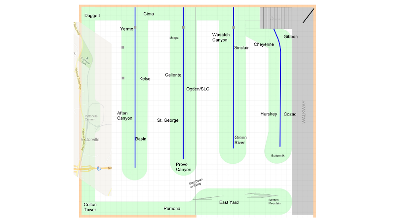

Sleeping on last night's sketch refinements resulted in this clarity:
Thick blue lines are backgrounds. Gray line down the middle is the change in floor level previously mentioned.

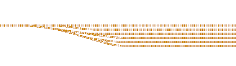

Before you even mentioned it a few posts ago, I was going to suggest a N-S peninsula orientation.   Before that though, I would encourage you to try and lay out the scenes you're especially interested in capturing as LDE's, then figure out how to string them together.   Laying out a bunch of linear peninsulas in a fairly rigid way like this seems too restrictive for a railfanning-style pike.
There are a lot of ways to lay out a compound ladder.  Here is a sample that has 1.25" track centers with Atlas #7s:
I don't think this has any scary reverse curves in it.

Good. Thanks for the ladder suggestion. That was what I had started but it wasn't looking right. The goal is a handful of yard tracks capable of 15' trains, and #7's make for really long simple ladders.
Yeah, the rigid peninsulas bother me, too. The backbone at the top has to stay, however. There are 6x6 support posts at the top of the plan for the catwalk and observation deck (gray boxes on slightly revised plan, below). These also dictate where the peninsulas go, or at least start. That step/ramp at Pomona also needs to be in one place only and more or less perpendicular to a walk path, which means the center peninsula or an equivalent has to cover most of the level change.
LDEs are Pomona-Colton Tower, Victorville Cement (narrow gauge there), Yermo-Kelso, Wasatch-Green River, loco shops at Cheyenne, and Buttermilk-Gibbon. One immediate thought is shortening the Wasatch peninsula and making the Cheyenne-Gibbon portion into an elbow to the left. That would move Cheyenne to the center of the peninsula, which works better. I don't want to get too "curvy" with the benchwork if it can be avoided due to the carpentry complexity, and curved benchwork eats square footage.
Also, I'm not a fan of "donut holes" in trackplans that IMO are the bane of HO since they create so much unusable space and create duckunder scenarios. In the Greeley trackplan, they are using their "donut holes" as workspaces, with access afforded by stairs descending below floor levels. That's a bit much.
Oh... don't think that the track will be strictly parallel with the edge of the benchwork everywhere. That's a no-no. Wait until I get some mainlines down for you; even the long tangents will be at angles.
Nice job Gary putting into words, what I was thinking.

Yes, I agree, but I could use a hand getting out of the rut. The big space is a little overwhelming. The hard parameters dictated by building features were already mentioned. I can mitigate some of the symmetry by narrowing cross-sections when it will work. Yermo to Ogden is the best candidate for that since it's single track with sidings. I'll also look at reshaping, such as making Victorville Cement more of a peninsula and maybe curving Afton Canyon around it.
(The 4" step-up in the center of a perfect square makes avoiding symmetry challenging if I'm using the layout to cover it. The alternative is to blow a lot of building budget and time on a 14 cu. ft. concrete pour inside a building, and then there's the stuff that would need to be deconstructed in the prep. Just to bring the floors to the same level? IOW, the straight center peninsula is a cheat to avoid a bunch of work solving a safety issue.)
One other design limit - no duckunders, not even non-public duckunders for maintenance/derailments. Gary, if you'll recall from earlier this year I had a temporary medical issue in the way of progress. This was spine surgery. I've been back to 100% since July, but if this were to become an issue again any duckunders would potentially make the layout unoperable to me. It's crap getting old, but it beats the alternative.

Mike, you may want to take a look at Jim Reising's plan again.  I luv the symmetry he's created.  It looks natural and not so rigid.
Yeah, the curves and such eat up floor space-- but you have a ton of floor space to work with.
Also since it is a railfan's pike, then maybe more open aisle-space would be a good thing– then one can step back and really take in a scene.

Thanks. I took another look at Jim's plan. It looks like the issue I have here is essentially the long uninterrupted arrow-straight benchwork, so it's not the symmetry alone, it's how it is "packaged". I'll work on that. It also made it sink in that keeping the 5' width (actually, two 30" sections sandwiched) the entire length of each peninsula is unnecessary, and plays into the rigidness issue.
But in my defense for these first drafts, AnyRail's object drawing tools truly suck. You can put track together like an SOB, but free-forming graphic objects like benchwork is tedious and error-inducing. And you need a sense of your benchwork, with constraints, before laying track. AR's issues are doing nothing for my 30-year professional bias/prejudice that European software designers wouldn't know a decent UI if it bit them on the butt. MacDraw from 25 years ago worked bunches better.
