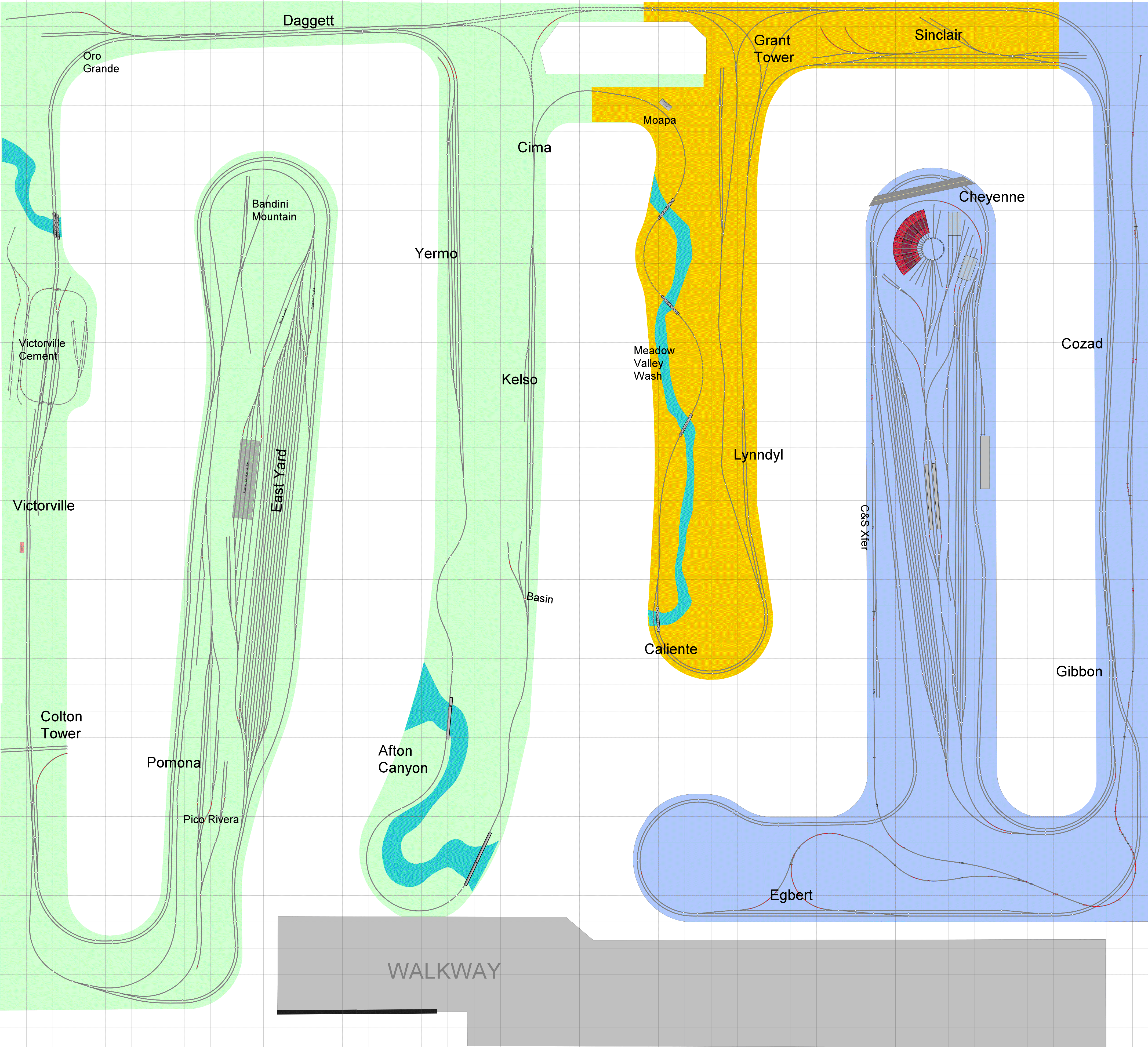

  • Posts: 11437
  • Respect: +2909
Re: Gibbon, Cozad & Western - "The 100th Meridian Line"
« Reply #564 on: July 25, 2015, 03:04:11 AM »
I have relented. :ashat:
Many months and pages ago, a couple of you (I won't name names... Gary... :D ) were haranguing me about not having any staging. I countered that by having yards as big as they are in the plan, staging won't be necessary. I have been mulling this since, unsure about how to work staging into the operating scheme and layout design. For the moment I seem to have a plan:
It's hard to see, but up at the top of the lobe there now is a "TO STAGING". I have worked this into the Los Angeles ("East Yard") end of the operation, creating a trench line between the double-track mainline (outer tracks) and the yard lead and support areas. The trench will lead to a 2.5-turn helix under the lobe, the helix entering a stub-ended (???) staging yard of 8 to 10 tracks below the left side of the upper benchwork.
Operationally, it is my intent not to stage full trains, but, rather, blocks of cars as "transfer cuts" to and from the SP and ATSF. Train arrives at East Yard, power and caboose are cut off and hostled to their respective service areas, yard job separates the "blocked" train, pulls the SP (or ATSF) block out, and sets it out to one of the two transfer tracks on the right. Switcher pops out of the trench tunnel and moves the cut to staging.
Although you can't see it in the cropped view, by inserting the transfer tracks between the yard and main, it is possible to route a complete train into the staging area. The stub-ended staging yard makes this less than desirable - I guess the power can be cut off and routed around on an escape track, 'cause there's no way in heck I'm incorporating an operating protocol that backs a 50-60 car train through a yard ladder and up a 1.5% helix! So I'm not sure yet if this feature will be part of the operating plan, or just allowed to be a fudge of convenience. Lemme think about this some more... there may be room for a balloon track on the staging level.
« Last Edit: July 25, 2015, 03:06:34 AM by C855B »

« Reply #565 on: July 25, 2015, 09:14:44 AM »
If there's any way you can do it, make staging double ended.  My staging yard works extremely well - six tracks, each of which will hold about 125 50' cars.
I generally keep one track open for run throughs.
I have the distributed power earthworm (108 cars) on one track, with the others holding two trains each (I have mid siding sensors, so it's easy to get two trains per track).
So that's nine trains not cluttering the visible portion of the layout but available instantly.

« Reply #567 on: July 25, 2015, 03:23:09 PM »
The room and building are looking great Mike!
Is there more than one of me?  ;)  Glad to hear that you are thinking about it, but you may be unwise to listen to me. My layout currently has three times as much track in staging as it does in visible main line... :facepalm: I agree with Jim that a double-ended staging yard is preferable, but I think you could make stub-end work in your configuration, because you have it connected to a big terminal.  I have a similar situation in which my (double-ended) helix staging connects to a stub-end storage yard at the bottom of the helix.  Southbound road crews will terminate their trains in helix staging, and the terminal manager will navigate the trains into stub-end storage.  To facilitate this, I put a helper pocket near the bottom of the helix so that head-end power could be cut off before getting trapped in the stub and the helpers could "push" the trains into the stub-end yard (the approach in is mostly down-grade).  You could do the same: have some yard power lower the trains (or cuts of cars) down the helix into staging from behind.
The scheme of moving cuts from the terminal into staging sounds intriguing.  It will give the yard manager some interesting work, but the actual transfers won't be a very interesting job for a visitor.  Best to assign that to one of your home-road crew members.
A note for Gary... we were talking about total lumens and I accused you of having surgical levels of lighting. Well, based on the performance of the troffers installed so far (5500 lumens each), your observations are vindicated. If I were relying on the troffers alone for primary lighting, given the space and ceiling height, I would need twice what I will have. The spot lighting from the track light system and of course the theater lights will more than make the difference, but I am still somewhat surprised that these "work lights" will be merely adequate.
I know just what you mean.  Despite how bright the ambient light levels are in my room, I still wish I had more light on the trains.  That will definitely happen on my lower deck, but I may end up adding some spots for the upper deck as well.

First, the catwalk is 95% done:
What's left is about an hour's worth, out of view of the pictures. More important - the catwalk is finished to the point where I no longer need to work on it from underneath, so I can resume ceiling grid build-out.
As to staging... I dunno about "clutter". Gary has a point about too much staging versus trains setting the ambiance on the layout. Let's discuss those big yards again in East Yard and Cheyenne. There is beaucoup room for lots of trains, both complete and in stages of assembly or breakdown. The yards need to be populated, and there's nothing wrong with "staging" trains in plain view. I'll just tell the yardmaster they're waiting for a crew. ;)
I'll work on the staging/transfer layer a little more and see if I can work in a loop or balloon. Certainly is room for it under the main deck, I'm just getting a little nervous about hidden track with potential access issues.

« Reply #569 on: July 26, 2015, 01:21:25 PM »
Mikey:
With what little I know about southern California, is there a staging opportunity at any of the multiple junction points with ATSF or SP?
Having Santa Fe trains on that last segment could add some nice operational twists - a long transfer cut could be a road train - and with UP being a tenant on ATSF across Cajon....
My guess is that you either weren't going to have much/any ATSF action, or that if you did, it wouldn't be running through to Cheyenne and points east.
Just my thoughts and 0.02 worth.  Progress looks good, will have to visit again soon.
