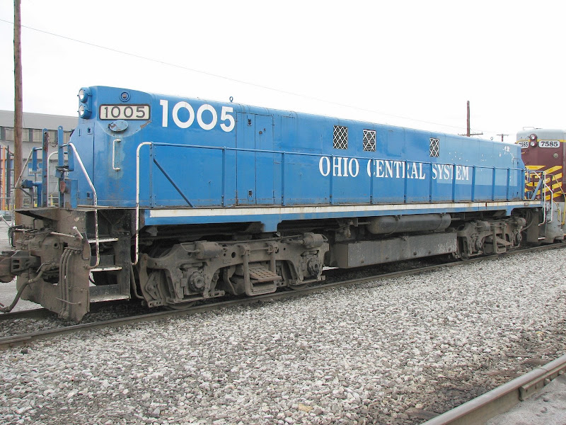

The 1005 slug started out as:
NYC RS-11 #8007
Then renumbered to:
NYC RS-11 #7607
Then:
PC RS-11 #7607 http://www.pbase.com/espeef5/image/38993225
Then:
CR RS-11 #7607
Then rebuilt into a MT-4 #1005 slug at Altoona: http://www.trainweb.org/railpix/misc...le-5-20-82.jpg
Then it got EMD trucks: http://www.rrpicturearchives.net/loc...e.aspx?id=5327
Then:
OC MT-4 #1005
lock4244

Chris,
I couldn't get the links to load.  What type of EMD trucks went under the 1005?  I'm still a novice at identifying stuff like that, but I'm getting better with more research and reading  I saw some early pictures that still had the original trucks, but by time it made it to the CR Q scheme, they must have changed already.  The pics I have in the Q scheme don't show the trucks really well, so it's hard to see them.
Thanks for the comments guys.  The gory details on the chop are here:  www.briansnscale.com/mt-4_project.htm
Brian

Chris,
Brian
Use Atlas EMD GP trucks, also available through the parts dept.  Just make sure that the country of manufacture is the same as the frame you kitbashed (Japan or China) so that the gearing matches.  If your original model was made in Japan, you also can use Kato old-mechanism F3/F7 trucks.
CORRECTION - I see from your progress log that you removed the motor and gearing.  So any Atlas or Kato GP truck from the Atlas/Kato era, or from the Atlas China GP30 and GP35 should work fine.

Brian,
Be aware that EMD B-trucks are different depending on the era of unit.  GP38 trucks for example are different than GP38-2 trucks.  When I kitbashed a Kato GP38-2 into a GP38 years ago, I had to swap in F3 trucks.  In any event, Atlas has both so you just have to order the correct set.  Those trucks look like pre -2 trucks in Chris' photo above.

Chris,
Brian
Those links worked a few year ago when I posted to a photo in my Railimages:
http://www.trainboard.com/railimages/showphoto.php/photo/7469/title/oc7591/cat/773
Under in the comments.
Sorry I don't have any recent links.
  • Posts: 9978
  • Respect: +2913
Re: Weekend Update 3/18/12
« Reply #56 on: March 19, 2012, 04:44:48 PM »
Try this:
http://www.rrpicturearchives.net/locoPicture.aspx?id=5327
and:
http://www.trainweb.org/railpix/miscpix/conrail1005s1-morrisville-5-20-82.jpg
1 - Has anybody seen a slug with the hood off ?
2 - If you put a ring of salt around a slug will it die trying to get out like the prototype . :)
