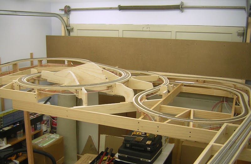

And why so stingy with the layout photos?!!  :| Why use just one to succinctly illustrate your point...when you can post two or three and give us a view of all the adjacent bench and track and stuff? Stop the teasing!!!  I have to say if I was there looking at your layout, and you were showing me something, I'd also be enjoying the chance to look at all the other nearby parts of your layout.
Ok Steven, this will teach you to ask for more layout shots.  Here's a pair that encompasses the upper deck work to date:
Now, could you please photoshop all the junk out of them like you did before?  ;)

That looks awesome Gary.  :o  Artist at work!!!

Seriously, one of the best thought and planned Tehachapi concepts I believe I've ever seen...viewed through the eyes of a railfan!

Gary, you're not planning to cover that beautiful benchwork with scenery, are you? :D
Very nice work!
