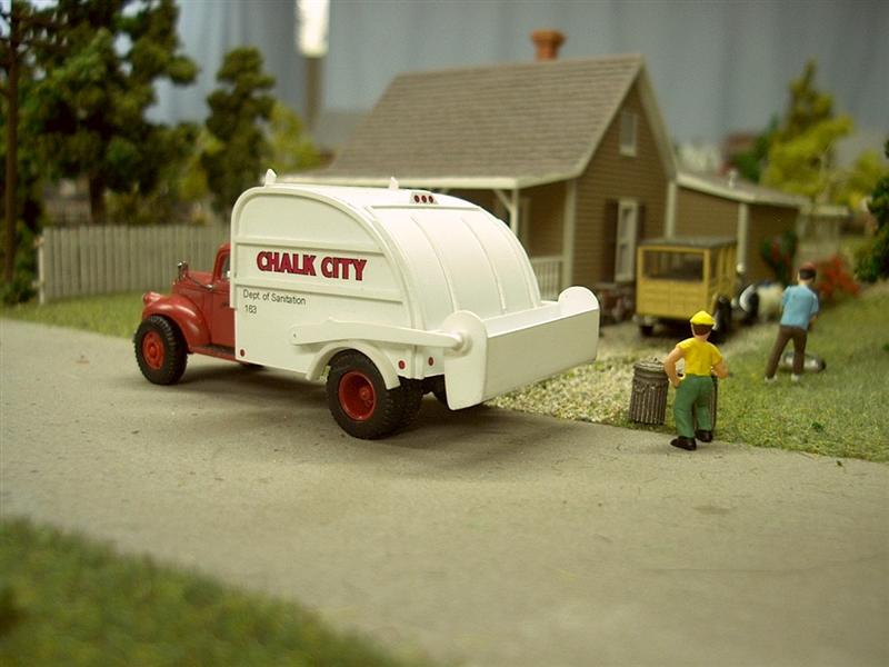

« Reply #218 on: March 07, 2012, 10:57:48 PM »
The garbage body complete. I have to make two more in HO now. I have a sheet cut for an N scale version but have yet to test assemble it. I have a bash together of a F-350 body on a White Super chassis to put it on. The F-350 wheel base and wheels are too small. The white sets too high to be a garbage truck. The Ford body sets lower and would be more reasonable for a guy climing in and out of the truck all day.
Tony Hines

Re: Silhouette SD
« Reply #219 on: March 07, 2012, 11:50:51 PM »
That's really great Tony.  Good job.
