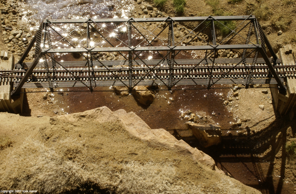

Thanks to David, Robert, and Chris for getting me set up with code 25 rail and track laying materials.  I admit, I had a really hard time laying the code 25.  Kudos to David for all of his work with this small rail.
The water is Magic Water with a layer of gloss medium to create ripples.
« Last Edit: September 29, 2007, 07:54:13 PM by tom mann »
Re: Mann's Picture Frame Diorama
« Reply #52 on: September 29, 2007, 10:44:00 PM »
Tom, congratulations on your foray into Code 25! It's "lots of fun," isn't it? But it looks great--hard to tell what scale you're looking at. Well done. Did you solder, or use CA, or both?

Love the photo!
Your a picture taken freakin genius  :D

« Reply #54 on: September 30, 2007, 09:18:39 AM »
Very nice picture Tom! Can you show us more of them? :)
Thank you...this is the only one that actually turned out. :)
The high F stop on my camera (F36) allows for the big depth of field this close.

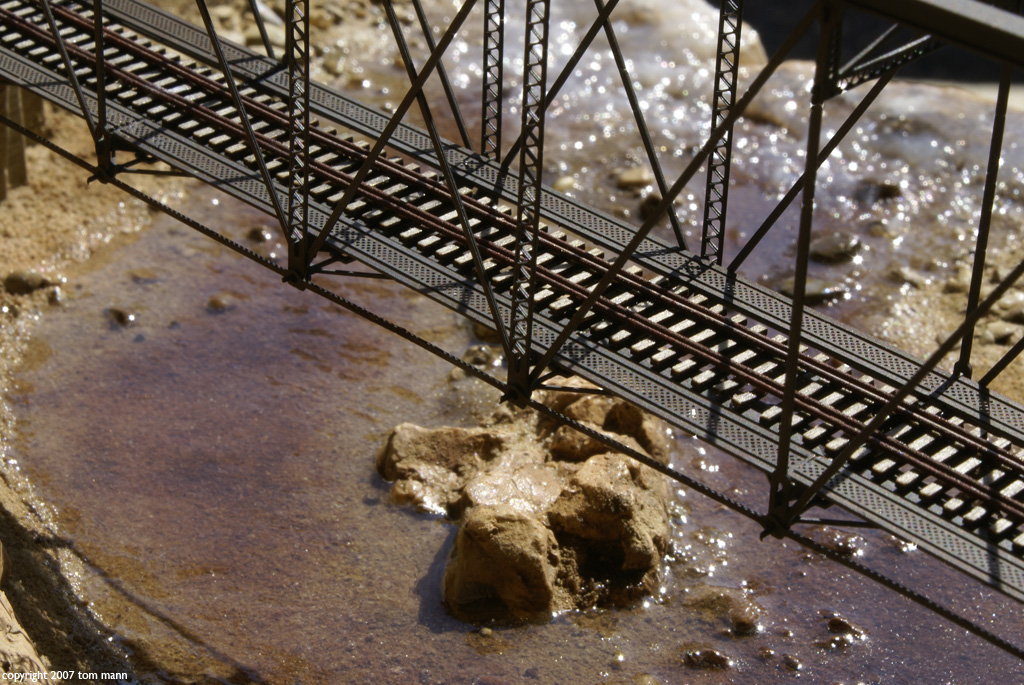

A few more photos and some "tips".  In the first photo, you can see the shore line looks wet.  This is a base coat of gloss medium before the Magic water is poured.  It keeps the Magic Water from wicking up the banks.  John Cubbin thought of this.

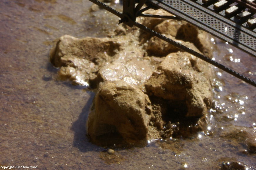

Water close up.  The bubbles are no way in my water, they must be real fish in there:
It is difficult to make bubbles if you gently stir the Magic Water, but easy to create bubbles with strippling the gloss medium.
That gel like crap at the top is caulk...once I figure out how to do the falls it might look good:
« Last Edit: September 30, 2007, 06:04:53 PM by tom mann »
One of the things I learned about getting clear caulk to simulate moving water effectively is to work with it on a sheet of waxed paper or scrap plastic until it starts to set. Just smear it around with a small spatula or flat stick, and when it gets starts to feel like taffy, then start smearing it in place on the layout. You have to work quickly, and it takes practice. Also, after teasing it into shape, dry-brushing on gloss white paint helps give it character. Applying it straight from the tube to the layout often results in that jelly-like stuff.
« Reply #59 on: October 03, 2007, 10:01:01 PM »
David,  I'll have to try that.  The nice thing about caulk is that it peels up fairly easily.  I think I'm going to lift an idea from Harold and mix white non-sanded tile grout in it for white water.
