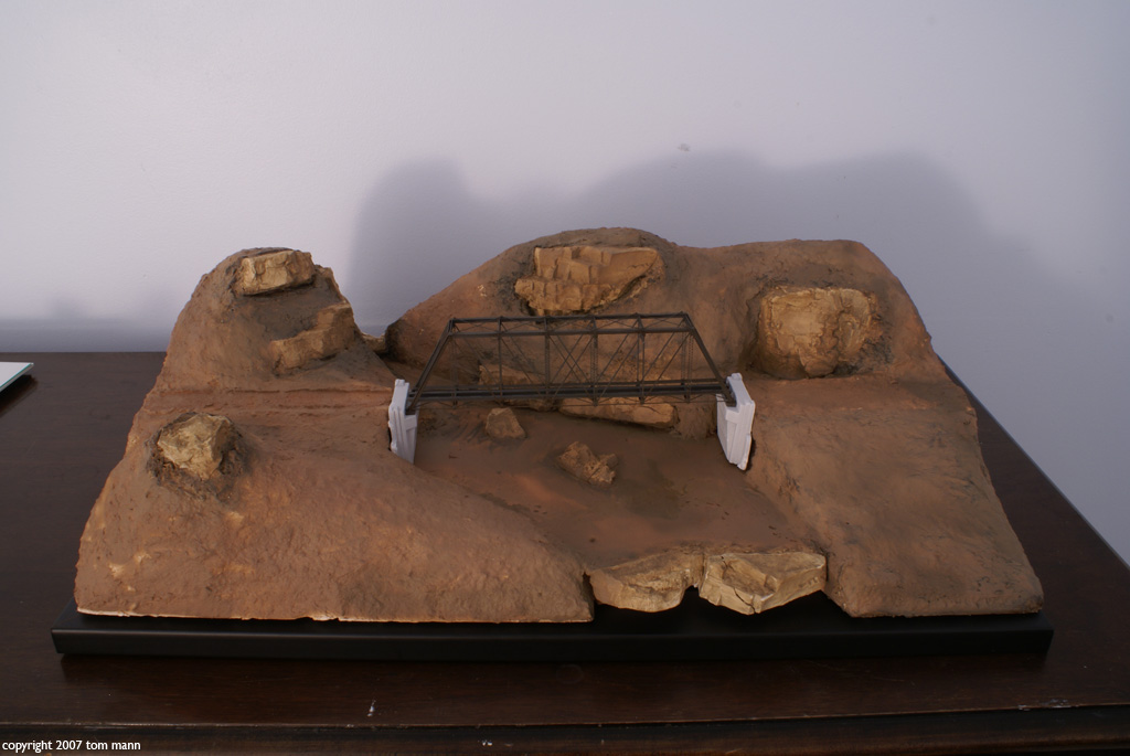

Ok, a little update and helpful tips and tricks from my own experience and from studying Jürg's John Cubbin-made dioramas.
1.  You'll need more ground behind the tracks than in front, since your photos could look down at the subject.  A way around this is to gently slope up the ground behind the tracks for top down photos, or add a large hill for both top down and bottom up photos.
2.  The ground in front of the tracks should be a drastic slope upwards, to allow for camera shots that look like they were taken trackside.  The large hill in #1 *could* be a height that is visible above the freight car or locos at this angle for added depth.

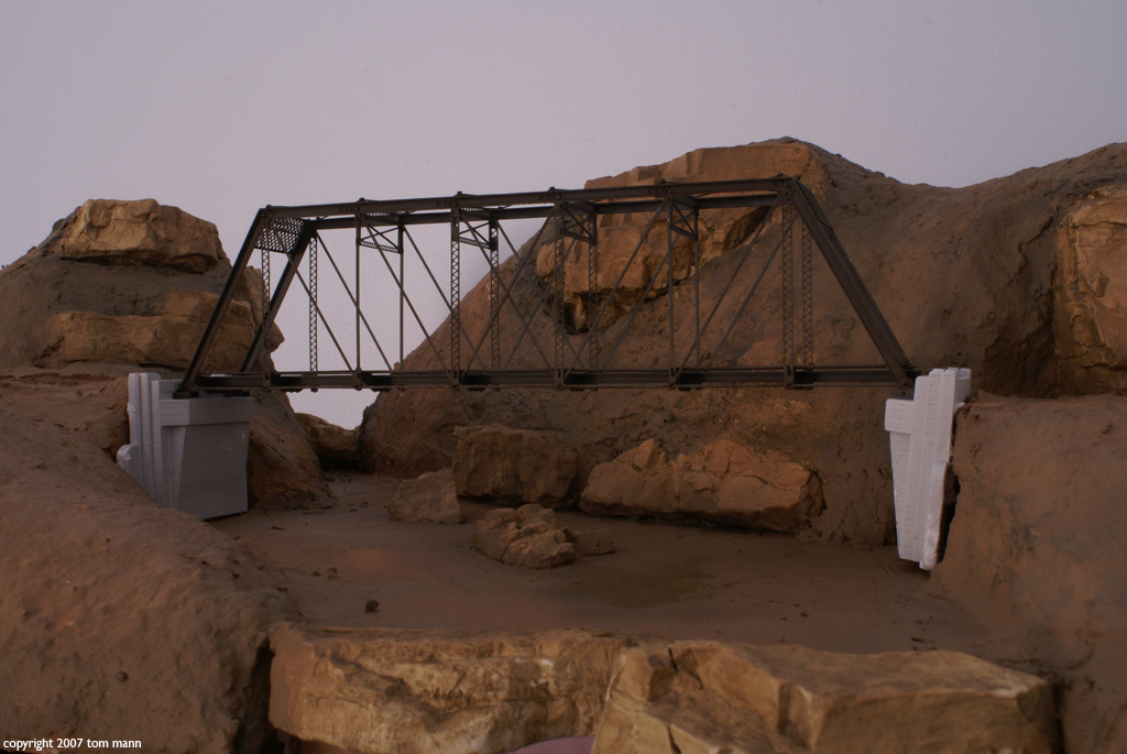

3.  Rivers should be as close to parallel to the tracks as possible to avoid entering the diorama in a manner that would be visible in most photos.  In my previous n scale diorama (due to faulty planning :-\ ), only the most top down shots work well because the river's source is apparent.  Ground can slope up to hide the "back edge", but water can't too easily  (other ideas:  a waterfall at the back edge; or as seen below, a curve and a rock at the edge, with a gentle taper to force perspective and minimize the river entry point).
The following two shots are foam and scuptamold painted with polyscale dirt and mud and Liquidtex raw umber.  I've learned that the rock formations should be installed before painting, so the surrounding sculptamold can be painted and blended in with them
I'll keep the diorama like this for a few days to make sure the rocks still look arranged properly.  If anything looks funny, please let me know.  I have a hard time placing rocks:  I mean, I do what I think is right, but with little rhyme or reason.  If terrain is too steep, I cut it out and slap a formation there. :)
I like the picture frame as framework so far.  It provides the structure for the foam to attach to and is a nice semi-matte black finish.
Next step:  placing dirt and rocks and securing them with matte medium.

« Reply #4 on: July 30, 2007, 11:06:12 PM »
Ok, two things:
1: You've done generic "western" scenery already. I was hoping for something more fitting your Chicagoland interests.
2: Be DAMN careful slapping that glue around, or you're going to have to refinish the the frame, and that would seem dumb. Spend some time masking it off.
Otherwise, top notch work, as usual.

Ok, two things:
You're right, Ed.  I've sold out to the western demons once again. :(  I find western scenery fun to do, that's all.  Rock formations are fun, sand and dirt scenery is fun, not using groundfoam is fun, etc. ;D
