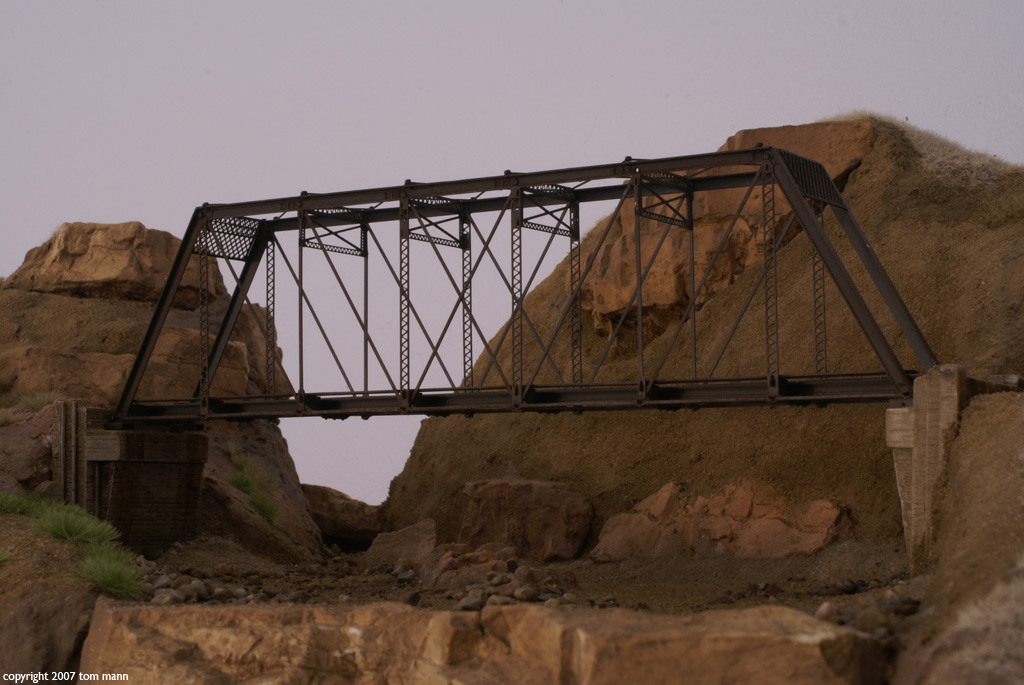

I did a little more work on the diorama last night.
I weathered the abutments using acrylic washes of various colors.  I decided to go extra heavy on rust streaks from the bridge footings, even though I can't imagine that there would be this much rust on a bridge out there in the middle of the desert.  I just think that rust streaks on a concrete abutment from a bridge is cool.  I almost - almost - put some graffiti on one of the abutments.  I decided against it, as to not limit myself to a certain era.
I used the Noch applicator to "plant" static grass on upwards pointing surfaces.  I use this light honey color from Woodland scenics that I think looks like dry desert grass.  I also placed a bunch of Silflor tufts in random areas, the greener (late summer) shade close to the river, and the lighter (autumn) shade away from the river.  This gives me three grass colors, all muted and similar in tone and feel.

Ok, a little more work tonight.
Here is an overview shot to show overall progress so far:
I'm working on the river first.  The river bed is dirt with a little sand mixed in.  To show a gradation from the river bank to the center, I paint a diluted mix of Polyscale sand and Raw Umber and attempt to feather it to the center.
