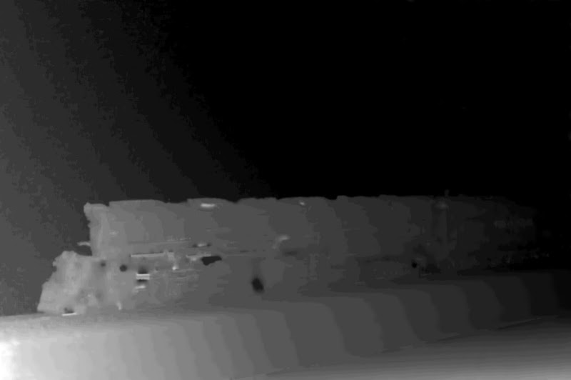

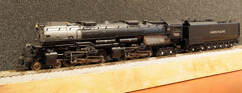

First up is a 36 file stack of an Athearn Challenger with a black back ground. Did I need 36 files? No. But since all I had to do was click a few settings in the software and walk away for awhile while the camera and software did the work, why not? The results are nice with a few exceptions. The handrails in front of the smoke box are fuzzy and missing and there are clear halos around the bell, exhaust stack and front sand box.
I eliminated some of the files from the stack and reprocessed it to see if that would help eliminate the halos and bring back the details but it made a very small improvement. You can see in the depth map where some of the rear files were eliminated (the bigger steps in gradients to the right) The idea was that these were the pictures where the background was in focus around the fuzzy details and halos. I thought that eliminating the background focus here, might improve the clarity of the front. It did, but not very much.
Next I tried a white back ground with a stack of just 15 files. Everything else stayed the same. The results are quite good.
