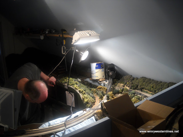

1. Spend more time testing things (if possible). I tried the software with the camera exactly once before going down to Lee's (that was the day before, after just having installed the software). It worked fine at home, but at Lee's, the lens wasn't focusing under remote control. There are a bazillion settings on both the camera and the software that have to agree before it all works (most of the defaults in the software were correct). It was faster to just manually focus the camera than to figure out what it wasn't happy about, so I did all of the focusing by hand. That said, even though auto-focusing was SOL, Helicon Remote still offered the advantages of being able to control all other aspects of the camera, including a manual shutter release, plus see a live view of what the camera was seeing. The value of all of this cannot be overstated, particularly when the camera is nearly inaccessible, as it was in this case:

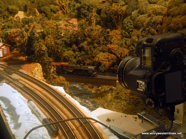

I was asked off-board about the "tripod" that can be glimpsed in this shot Lee posted--
That's a DIY thingy I built just for the shoot to hold the camera on its side down close to the ground. It cost just a few bucks and took just a few minutes to make. It consists of one 5-inch angle bracket and two 6-inch flat brackets, bolted together with 10-24 flat-head screws and nuts, plus four rubber feet. I also applied a piece of self-stick felt pad to the bracket to help hold the camera secure, since it would otherwise come loose too easily.
The camera is mounted to the "tripod" with a DIY knob-bolt assembly. I found a knob with a 1/4-20 threaded insert (camera tripod mounts are universally 1/4-20), so I cut a piece of 1/4-20 bolt to thread into it to make an attachment knob.
It's pretty versatile, since you can swivel the feet around as needed. Presumably one could also add another L-bracket to hold the camera horizontally, essentially making a "low boy" tripod.
Everything to make one can be found at Lowes, or most any big box outlet or good hardware store.

The only problem with a beanbag is when the camera is on its side, such as this case. The cable emerges from the side of the camera on which it would otherwise be resting. Might be able to flip the camera over, but the viewfinder would then be pushing into the tunnel.
