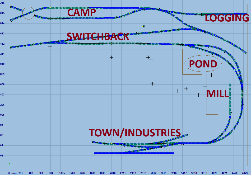

Hi!
I am starting a new layout build in a 3,2m x 4.7m room on a logging theme.
I have not decided yet if it is going to be On30 or Sn3.
After multiple failures and passes, I have come up with this track plan:
https://intrain.app/modelrr/trackplan1.png
Any comments are welcome!
Thanks!

I'd say the only thing to add is your common-carrier interchange to the outside world for lumber shipment.   Standard gauge.

« Reply #3 on: September 11, 2026, 03:22:56 AM »
Yes, I had that in mind, but forgot about it in the meantime. Thanks :)
