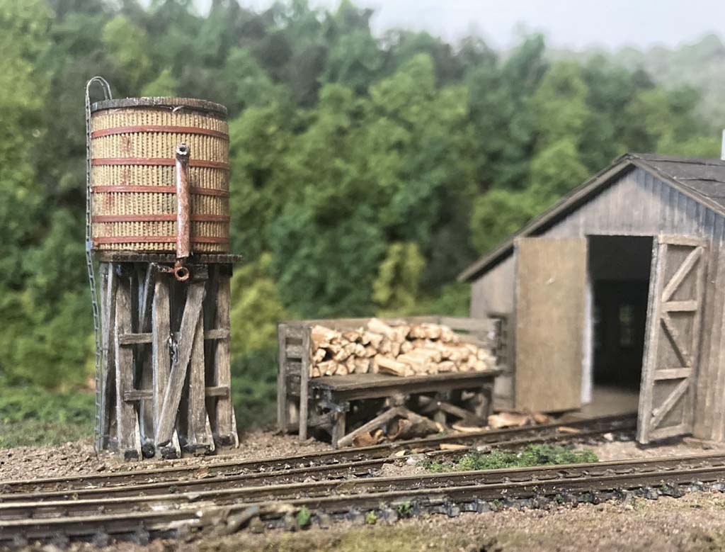

I've been using Micro-Mark tie stain forever, gone through bottles of the stuff.
I've got a big stripwood project underway for the Barge Yard trestle....and went to order more.  It's gone    My favorite was the 'brown-gray' 83760.
I 'think' it was an alcohol base, don't know, but wondering what others are using for stripwood stain.
Well, that was fun while it lasted.   Projects like this ate a whole lot of it, the entire McCabe Mill facility was stained.    This is the color I still want to hit:
link:  http://www.randgust.com/McCabe16.jpg
That's not a classic 'india ink", it's better than that, no idea how to replicate it now.
« Last Edit: February 04, 2026, 03:19:28 PM by randgust »
