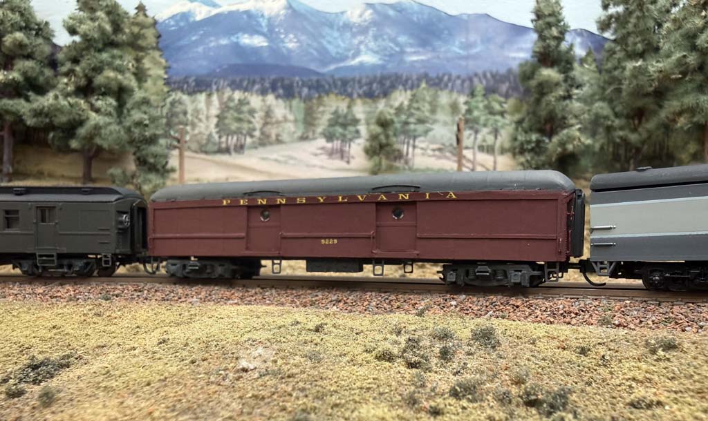

Love that traction terminal!
I'd been looking for my own PRR B60B for both my 'old' PRR local on the PRR Ttrak modules as well as finding out that PRR B60's were on the Santa Fe fast mail as run-through cars.  Maybe the only car that can be on both layouts legitimately.
I was campaigning last year to beg, borrow or steal one for my Ttrak runs at Altoona of the PA-powered Fast Mail.
So thanks to Lemosteam, I finally got an old Hell Gate Models kit and actually finished it, for my own.   I'm happy with it.
Also got an education that if it had roof vents, it was a messenger car.   Came with and without them.   Mine would be run-through mail storage, so the lack of vents is appropriate.
Link:  http://www.randgust.com/B60b01sm.jpg
