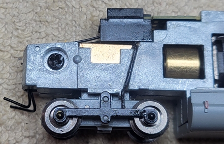

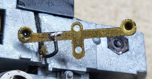

The fuel tank on mine sits so low that it will get hung up on rail joins if there is any unevenness in the track at all. I had the same problem with the first run of Scaletrains SD40-2's, however the problem here doesn't appear to be an assembly glitch like that one was. I don't have an LL GP60 anymore, so I can't compare. But maybe they've always been this way and I just never noticed before.
Also, I was getting a lot of stalls at slow speeds, so I decided to check out the axle wipers to see if they had been blackened (ala the Atlas SD45). And sure enough, they were -
The sort of hilarious part is that they actually did burnish the blackening off of the contact side of the wipers. However, they neglected to clean out the holes wherein the axle ends seat :facepalm:

So this model stills uses the original chassis and the trucks aren't wired like in many other recent Atlas releases?

« Reply #24 on: July 16, 2025, 09:46:28 AM »
Look at my pictures, the trucks are clearly wired.

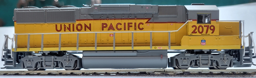

« Reply #25 on: July 16, 2025, 10:41:37 AM »
Here is one of my Walthers LifeLike GP60s.  The fuel tank clears the railhead on both of mine.  It is close, like on the prototype (see my first posting in this thread).  Also mine have the same extra plastic on the trucks.
The prototype photos I posted earlier were ones I took on the old Rock Island line over 10 years ago in Chickasha OK.
-Mark
I did Mark. I looked at your https://spookshow.net/loco/llgp60.html page (Atlas EMD GP60 released in 2025) and I am obviously missing something as the newest chassis shown has standard Kato-style pickup strips (the photo I linked to in my last post).
That same page also covers GP60s from  Walthers (2012), and Life Like (2012) models.  The only other GP60 there is from FVM.
  • Posts: 11897
  • Respect: +954
Re: Atlas GP60's
« Reply #27 on: July 16, 2025, 11:48:22 AM »
I did Mark.
I think Mark (Spookshow) meant this photo from his post above:
