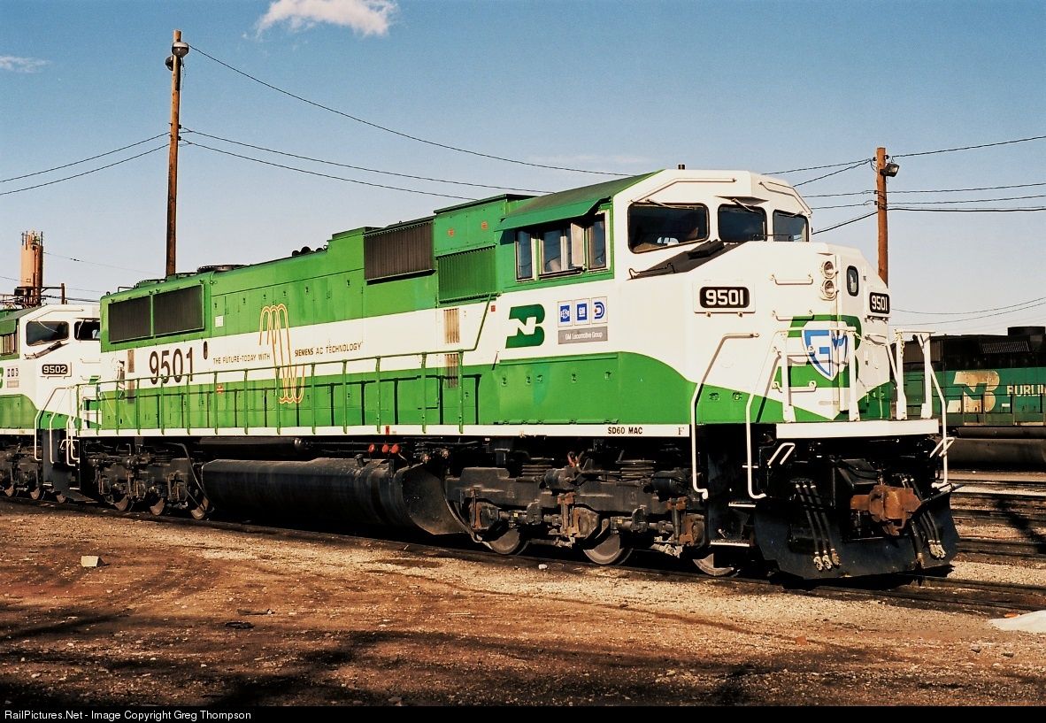

I'm slowly building an SD60MAC and having a few problems determining the correct shade of Green. It's not the standard BN Green nor is it the Executive color green. I would appreciate a few comments on colors that would put me in the ball park otherwise I'll just have to go by eye and what's on the net in photos.

Looking at my photos that were taken on a dark day, it appears the green was slightly lighter than most BN locomotives of that time period.   But there were a lot of color variations with BN green, depending how who painted it, how fresh the paint was, and most importantly, how much dirt was on it.  Plus that was the time period of BN's "White face" scheme, and it would seem more white on the locomotive made the green seem different than older locomotives.
There's a story I remember, don't know how true it was, that an "expert modeler" went to a manufacturer's booth at a train show to complain that their BN colors weren't correct.   The vendor rep pulled out a photo of BN's Denver engine terminal, where there were a multitude of different shades of green paint on the various locomotives, and asked the expert "so tell me which color is correct?"
Give it your best shot.  Those weren't in service that long and I seem to remember they were kept cleaner than most coal motors.

There's a discussion about this on the Atlas Rescue board, and while I completely disagree with some respondents' contention that it is just regular BN green due to "white vs black adjacent", I do think that one suggestion of adding a little yellow to standard BN paint* is probably pretty spot on.   Here's a good pic of both paint schemes fairly unaltered...  https://flic.kr/p/2kKyzJw
*What standard BN paint is, well that's also up for debate.   OG Cascade Green seems much more "olive drab" to me than the green that you saw early-80's and beyond.   I would refer to this later version, as shown on the SD40-2.

What if you compare the SD60MAC to other BN locomotives that were painted by EMD.. (SD60Ms?)
It might be 'BN Green' but EMD Shop BN Green vs the Green used by BN Paint shops..
Just a thought.. ~Ian

From what I've seen/heard, it was BN green, just seems light due to all the white on the loco. For paints currently available, I'd say Modelflex is the brightest green

Assuming the BN logo on the cab side is Cascade Green then it is a lighter/more yellow shade of green.
