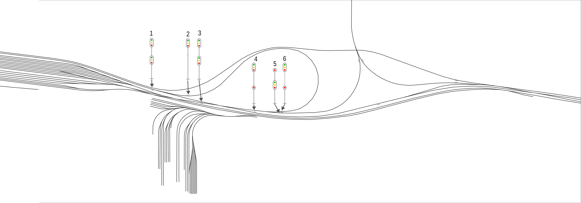

February 05, 2025, 03:56:15 PM »
Ok, here is a picture of the track, in the meanwhile they added some more turnouts.
1, 2 and 3 are ok and they are clear for me.
4 is also ok, all for the main track and enter the yard with "restricting".
6, the same for my opinion, from loop track to main and yard,
5 is the signal what confuses me, the signal from the northbound rail

February 08, 2025, 10:07:38 PM »
After looking at some pictures of the spot ... are you sure that 5 isn't the same as 4 and 6?
For all of those tracks the upper three light signal would indicate an aspect for continuing on the main line and red-over-red-flashing would indicate entering the yard. (Most likely, I'm making some reasonable assumptions.) If I'm correctly understanding that they all face compass east (i.e. they're for compass west-bound trains).

February 20, 2025, 06:20:57 AM »
Hm, seems to be a complex question.
My idea is: the northern main joins the east-west main, so the northern main ends and diverges on the east-west main. So I assume there is no continue on main because it ends here.

April 10, 2025, 04:10:02 AM »
I studied now some documents and rule books.
Following I will describe the signals, If I’m wrong on anything, please correct me.
Signal 1
Continuing on main track
clear; approach clear; approach …..
Entering the Loop
Only possible via diverging approach (9.2.11) because we have to assume signal 6 is red due to blocked turnout or yard entrance via restricting (9.2.13).
Signal 2.
Exit loop via all single head rules.
Signal 3.
Exit yard onto main, diverging route or into the loop.
Signal 4.
Continue on main, or enter yard via restricting (9.2.13).
Signal 5.
Continue on main
Only possible via diverging rules due to speed limitations of turnouts and the downhill gradient in the curve from north to west.
Enter yard via restricting (9.2.13).
Signal 6.
Continue on main
It could be clear, because loop entrance is only possible via diverging approach (9.2.11) so the train is at limited speed and prepared to stop. As the train is in the loop and short enough and the turnouts get switched the signal can be flipped to clear. The train is slow enough that if it accelerates, the train is out of the loop until it may reach critical speeds for the turnouts. Other single head rules also possible.
Regards
