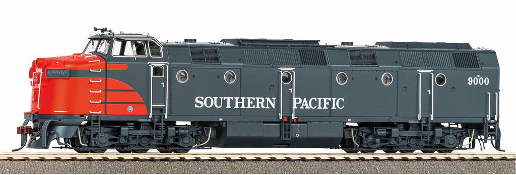

PIKO has produced a Whitcomb loco model in both HO and N scales.
I'd be inclined to wait and see (or inquire) if their (HO) Krauss-Maffei model will be made in N scale.
https://www.piko-america.com/
Despite being a transition-era steam modeler, if they offer them, I would buy a pair in a heartbeat… and use them to pull my Kato California Zephyr set I received for Christmas a few years back.
How a locomotive can look so ugly and yet so beautiful at the same time remains a mystery!!
