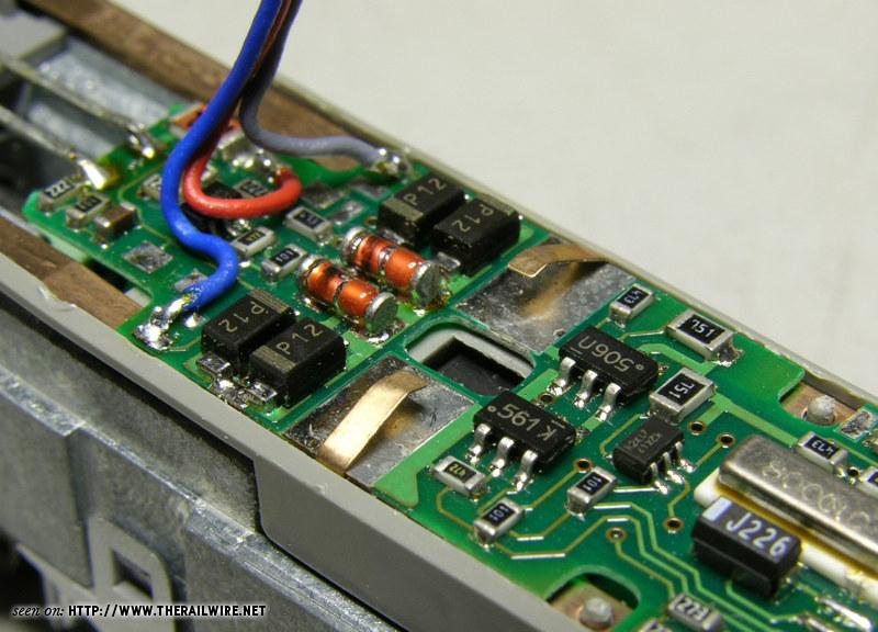

I didn't solder the motor contacts in my P42.  Instead I bent them as shown here. The gray Kato clip seems to put enough pressure on those bent contacts to allow the model to run.
I have not done a write-up for this install (I did it years ago), but the photos are all accessible in this album:
https://www.therailwire.net/forum/index.php?action=gallery;su=user;u=2700;cat=922
Some photos show alternate routing of the motor strips through the motor cradle - that is for another brand decoder which has motor power pads on the top and bottom of the decoder. Not applicable with Digitrax decoder.
I dislike depending on Kapton tape insulating the truck pickup strips from the motor strips.  Kapton tape also adds thickness to those truck pickup strips making the connection of them with the decoder less positive. As you see in the photos, I notch the truck pickup strips so they will not touch the motor contacts after the decoder is installed.
