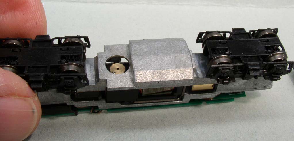

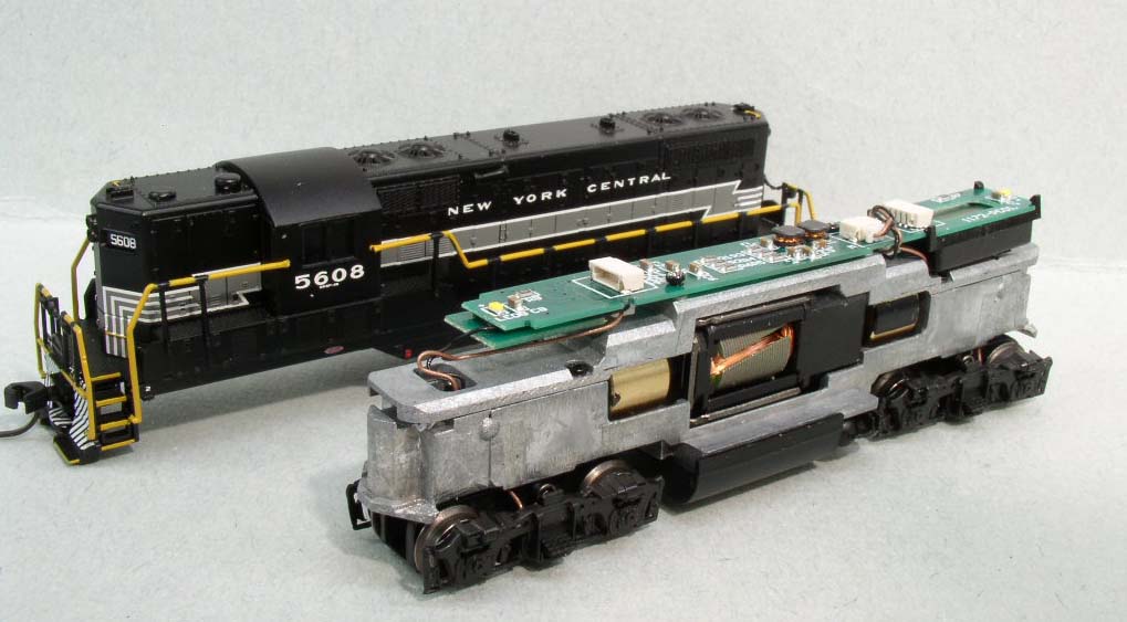

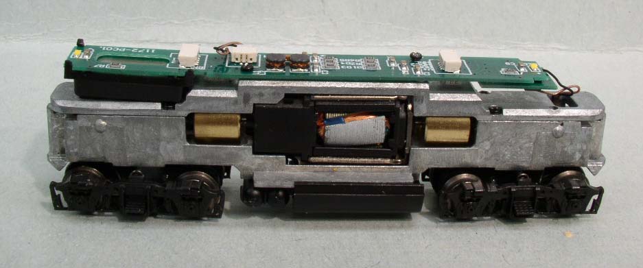

OK, here's some photos of the DC version:
1)  Basic shell with the shell off.   Notice the speaker at rear.
Link:  http://www.randgust.com/ATL24001.jpg
2) Right side:
Link:  http://www.randgust.com/ATL24003.jpg
3)  Bottom.  No longer split frame....
Link:  http://www.randgust.com/ATL24005.jpg

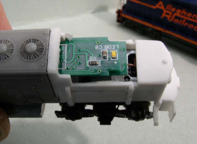

Now, here's my issue.  If you look at the board, there's a couple observations I don't get.   First, two white plugs on top of the board, facing outboard.   What are those for?  Second, the parts diagram shows two different 'daughterboards' under the main board in the nose, one for DC, one for DCC.   Is this like the SD7?   And you can see, on the DC version, there's just not a whole lot of room in front of the DC board to fit my CF7 cab, if the DCC board is much longer, it won't fit at all.
Link:  http://www.randgust.com/ATL24026.jpg[/img]

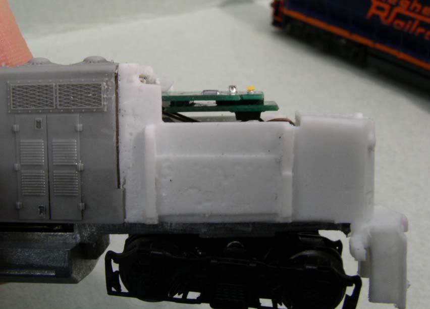

Side view.  If you see those 'notches' that's where the front cab window fits, so I have what appears to be 18 scale inches or .1125 in front of the STOCK TOP(not DC daughterboard on bottom) to clear my CF7 cab windshield.   That's the dimension I need to verify if anybody has a DCC version yet.
link:  http://www.randgust.com/ATL24027.jpg
