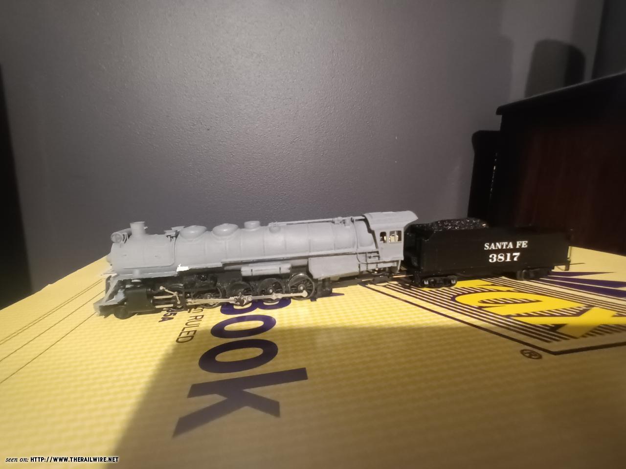

I'm building one of Santa Fe's 2-10-4 Steam  Locomotives, number 5000 Madame Queen.
Proto Photo:
http://m.rrpicturearchives.net/showPicture.aspx?id=3749992
I'm using Adams (draskoasshat) shell that he has designed and has available. It is has a lot of detail and is exquisite, it fits on a Concor 2-10-2 mechanism with some alterations
I'll post pictures of progress
Right now here's where it's at

here's the tender - from Dirk, he assembled it and added the details
Here's the Concor 2-10-2 mechanism before being altered (I have removed the front pilot)

I modified the Concor 2-10-2 mechanism so the shell can drop onto it. I still have to trim the pipes going into the steam chest (cylinders).
I ground away a fair bit of metal around the motor.

I have test fitted a practice shell and it's sitting a little high. I need to work on it a bit  :D

I milled out more of the frame and got it sitting lower, however, I need to mill some more off the top of the mechanism to get it snugged down to where I'm happy with it.

Getting closer!

So now the mechanism is about right, time to repair the Practice shell, made a repair to the walkway.
The next clip is the actual shell I'll use.

After quite a bit of fettling involving removing the metal that holds the motor in place and rotating the motor by 90 degrees the shell fits perfectly. I now have to make a styrene sled to fit under and support the re-oriented motor. As you can see I need to clean the mechanism thoroughly - strip down, clean and relube.
