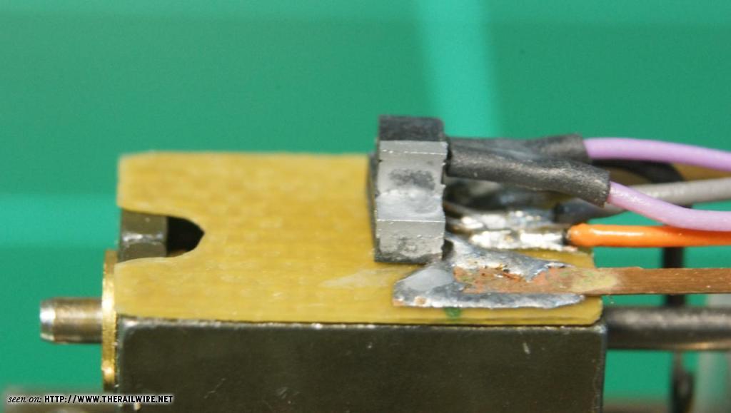

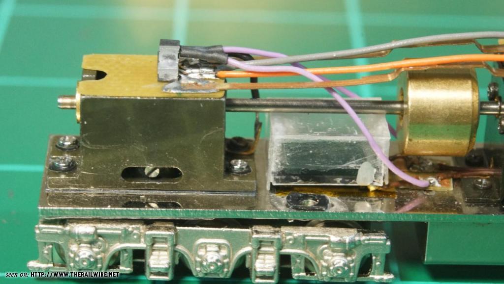

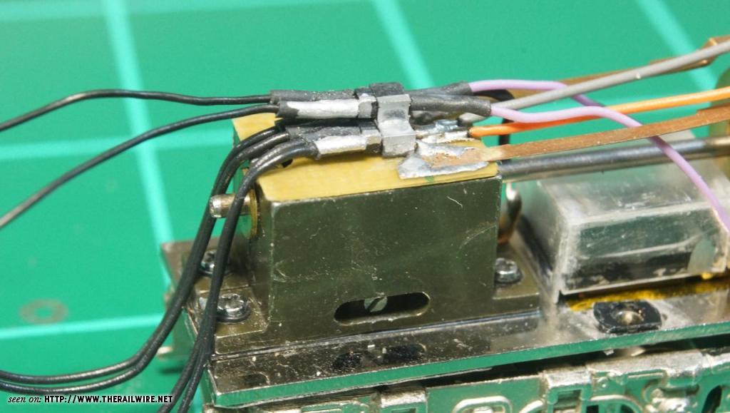

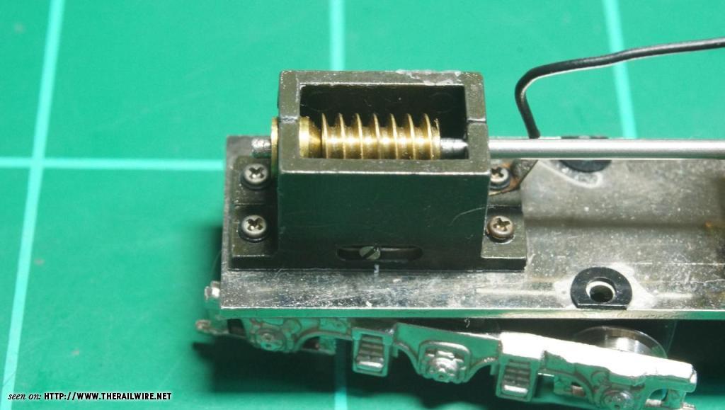

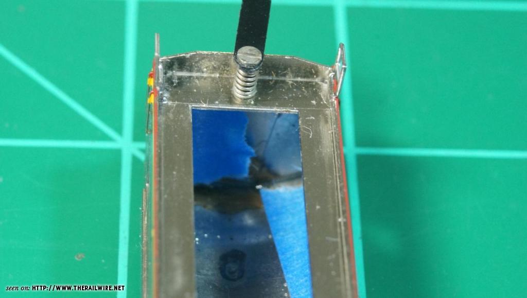

If wires come off the A unit  rear gearbox and come out.. they will be pinched between the shell and loco frame.   So I need to cut notches on that shelf where the drawbar post is located.
With notches cut, the chrome plating is now broken and could peel one day.  So after I smoothed everything off, I then added flux and solder over the exposed areas to keep the plating sealed.
I then built my plug with strands of thin black wire.  They are DCC color coded in my mind- but obviously want black as visible.  DCC colors nearest to far are:  red, orange, gray, black.  (rails to the outside and motor wires to the inside).
I then replaced the shell on the A unit and the wires came through their notches perfectly.  The wires are paired.  Black and gray on one side.  Red and orange on the other.

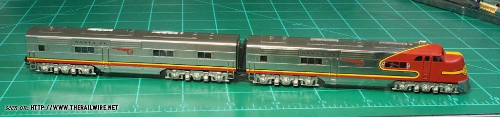

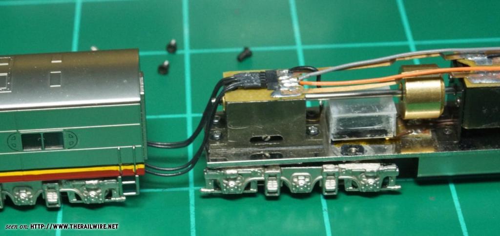

Now I encounter a challenge.  How long do I make my wires?  I decided to put shells on both locos and drawbar them together.  Now I can measure the final distance.   I notice in this photo that when using the grid on my mat,  the axles closest to each other almost fall on a line.  THAT is my reference.
I then remove the B unit shell and place the chassis on the grid lines like before.

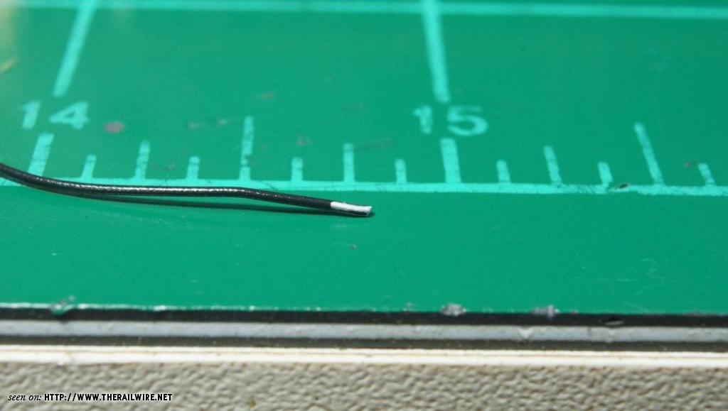

With the A unit shell on, I realized I could not be certain which wire was which.   So I pulled the shell and marked the tip of the rail wires (red and black) with a silver marker.

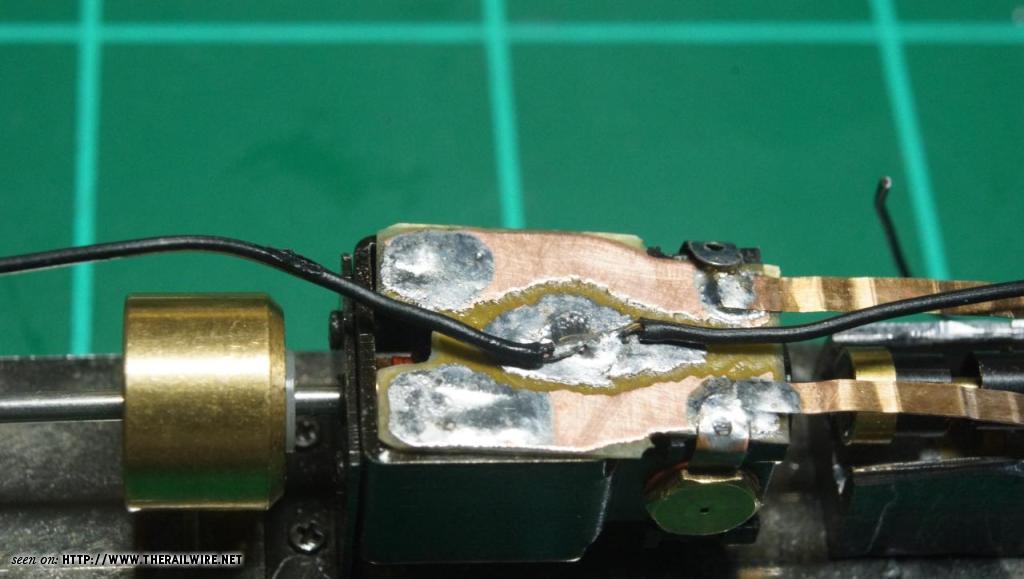

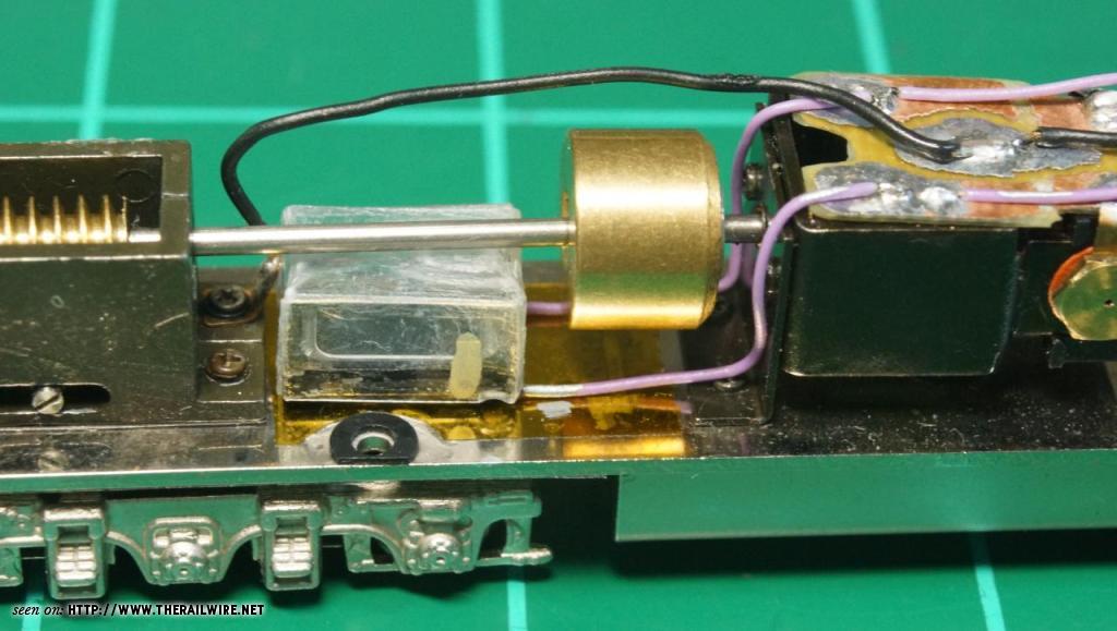

I then made two circuit boards for the B unit.  Lets start at the back.
The rear gearbox is powered to the left rail.  So the jumper wire goes forward to the motor board.
The board over the motor is connected to the motor tabs.  I then have an island in the middle for that black wire.  More VO-1000 strips, but these do not have to go over a flywheel.

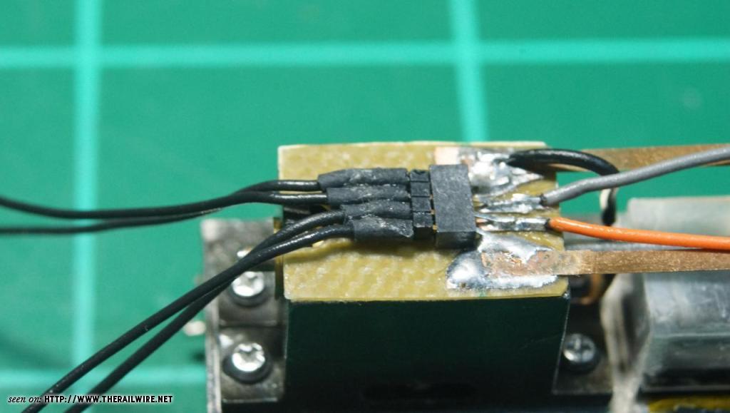

Then there is a board over the forward gearbox.   The front (right) side is divided into four lines to match the A unit.   From near to far:  red right rail, orange motor, gray motor, black left rail.   On the rear side of the board, I made the orange and gray traces larger for pads for the VO-1000 strips.  A second black jumper wire goes from the island over the motor to the far side.  A short jumper comes up from the gearbox on the near side.
Also seen in this shot are two wires temporarily soldered from the A unit.  Axles (almost!) on the grid lines.

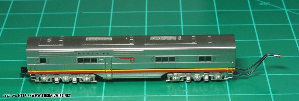

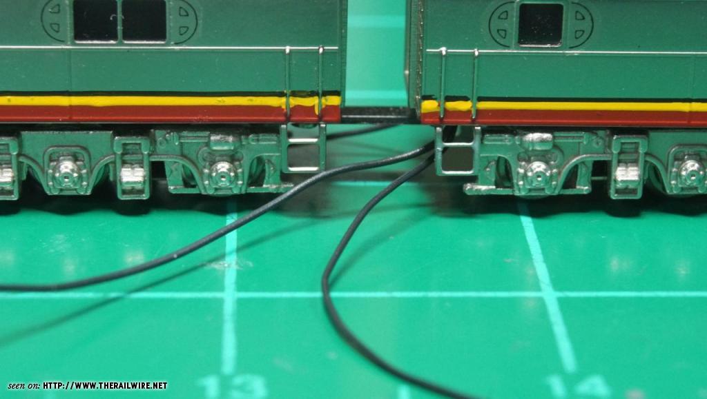

I made a guess visually as to how long the wires needed to be.  Imagining the shell installed.
I used a screwdriver to stretch out the wires to get them sort of even.

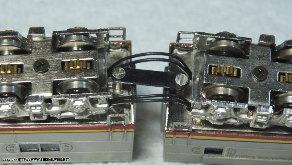

Then, with the basic length determined, I stretched the locos out.   NOW I could make all wires the same exact length.  Notice that there is not plug and socket here.   The wires are just soldered on.
Cut notches and solder notches on the B unit shell.    Install the shell, and the drawbar.  A little tricky with no foam cradle.
And now it looks good.  A little far (as is most N scale) but looks good otherwise.  The wire drape is just right.   A little dip- but loose enough for curves.  And if I feel they ARE too tight for some curves, then I just need to move the wires on the pad of the B unit for more slack.

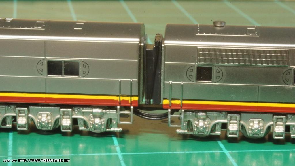

Well, time to wrap up this project.
I decided to try the suggestion to add some American Limited vestibules.
I used part #8510
It turned out that the draw bar was not long enough for two vestibules.
So I installed one on the A unit.
As it is, the one vestibule touched the B unit when on a straight.
On 15” curves there is a slight gap, but I can live with it.
My parts bag had one Kumata vestibule.  So I installed it on the back of the B unit to complete the look.
