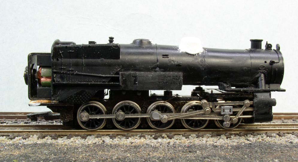

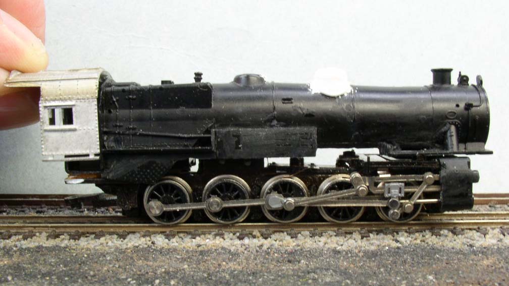

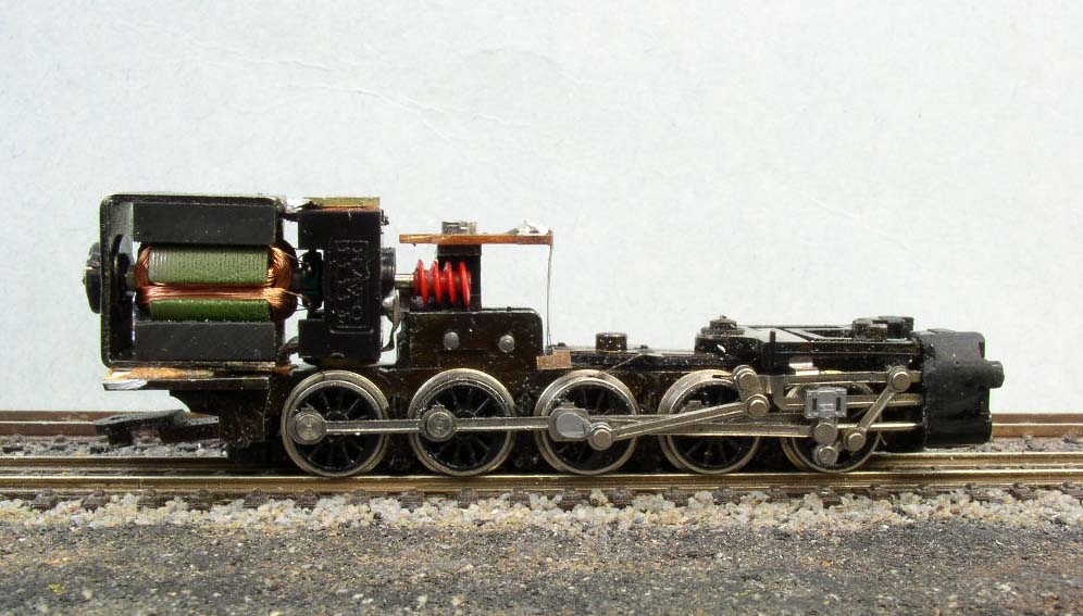

« Reply #93 on: March 26, 2023, 08:56:31 PM »
Meanwhile, back in reality....
The Kato motor mount is done, looks pretty good, did well in the cradle and after the Goo sets I'll wire and start testing under load.  But the low-RPM torque is pretty darn good.  Even with the workbench throttle, I could get it to crawl.   John's sand dome is on now too.   There's JUST enough cab to hide it.
link:  http://www.randgust.com/PRRL1008.jpg
link:  http://www.randgust.com/PRRL1009.jpg
link:  http://www.randgust.com/PRRL1010.jpg

Although you might not see it, there's an insulator strip between the bottom brush holder and the frame.   I'm still not sure if I'm doing this DCC or not, I have to get it to run right first, but the wheels are insulated from the frame, and the motor is insulated from the frame, so it's possible.
I want to redesign the plug system to the tender to be a little more flexible, particularly if this ends up being a 4-wire hitch instead of 2.
John, I'm kinda hoping that by the time I get this thing to run right you'll solve the pilot deck and air tank problem for me!
You also can't see it but there's a big lead slug pounded into the front of the boiler ahead of the original cast weight.   I also reprofiled the steam dome to plug the screw hole.   I've reduced the plastic boiler to an undetailed shell, I'm following Max's article on detailing it and I have pretty much all the parts.   Brass running boards are done but not attached.
Note that I had to tip the motor just a hair to make the ex-Roco worm engage fully.  I think the rear-end shim was .010.   And it's very counter-intuitive to glue the motor to the frame, but I've done this with these on 6 locomotives before and it's worked just fine.   Those Kato motors are just incredible for performance.
