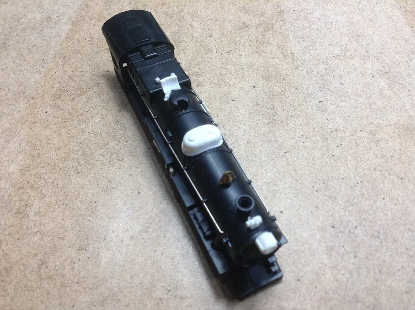

You need the sand dome that I have,  it makes a huge difference with little damage to the shell.
https://photos.app.goo.gl/8YfZTZBsK7u6bSET6
  • Posts: 3285
  • Respect: +3005
Re: You think I'd know better - Trix 2-10-0 rebuild
« Reply #62 on: March 01, 2023, 01:23:59 PM »
Shapeways marketplace is just so terrible..... is that the "Bachmann" sand dome or something else?
I agree and will get a couple as soon as I can figure out what it is.
I'll have to do a full inventory here and see what else you've got I need, I ended up with a lot of your parts  on the D16.   I still have a couple water scoops.
FYI I was very surprised how miserable it was to find a Elesco feedwater heater.    Got one but, wow, near miss.   And I'll also tip you off that Monroe  has no more GHQ L1 parts, I think I got all of them out of Marshall's collection.   One of the biggest discrepancies on the Trix models is at least compared to the GHQ cab, the Trix cab is a lot bigger and longer.   I suspect that was to hide the motor, also carried over from the K4, but if you look at the GHQ part you'll see there's just no comparison to the Trix, GHQ is way, way better.

Yeah, I 'think' this is it just looking for a confirm:  https://www.shapeways.com/product/EWMCYNUWE/2pk-n-scale-bachmann-prr-k4-replacement-sand-dome?optionId=58671376&li=shops
Hi Randy,
just use my website- then you don't have to search for anything.  www.keystonedetails.com.  Also look at the photos link below the image. all of the detail parts I offer are in it and how to install them.
If you can spare one, mail one of the GHQ Elesco feedwater heaters to me and I will model it up in CAD- been meaning to do that for a while.

Domes ordered and the Elesco feedwater heater mailed.   That's a missing detail part that only you can probably fix, so I'll do my part here.
I got the new brass drawbar off of the Kato tender frame designed and fabricated which is a major step forward.   Wire in the tender to the plug and I get to start testing this thing.

Finally got to start the real work of testing this thing, here's what I've learned:
1)  The Kato tender trucks certainly solved the pickup issues.   I could run this thing reliably just with the tender..   The new brass drawbar plus the detachable plug track just fine.
2)  It runs better in reverse than forward.  The #2 and #3 drivers have a noticeable eliptical movement to them; a borderline bind but only in forward.   There's too much vertical movement in the axles/gears.   I suspect that the pickup wipers (that I removed) prevented that so I put them back as a test.   Yep, that got rid of about 90% of it.   Modified them to wheel tread instead of flange edge.
3)  Put a lead slug in the front of the boiler and carved out a little of the plastic to slide the original weight up, that works.
4)  Put some test weights in the tender, and now it is all rock-solid on pickup and tractive effort is pretty good, not GHQ pewter boiler good,but good.    Overall performance is acceptable but not particularly outstanding.
But that Trix motor doesn't have the slow speed I want.   It runs nicely at medium-high but won't creep.   I've got an old Kato 5-pole that is a little wide but same dimensions otherwise that I think I'm going to put in, I've used these motors in old Roco GP's and also my RSD15's and they are just completely bulletproof, powerful and low-RPM.   These were the original Kato/Con-Cor PA1 motors, one of the best five-pole motors ever made if you can make them fit.  I had three old Roco/Atlas GP's that I'd repowered for a friend that I got back when he passed, the only thing worth keeping was the Kato motors, so this will be the second life for one of them.
That's what I mean about I'm not taking the detail thing flat out until I'm happy with the mechanism.   Right now, OK, but not great.
