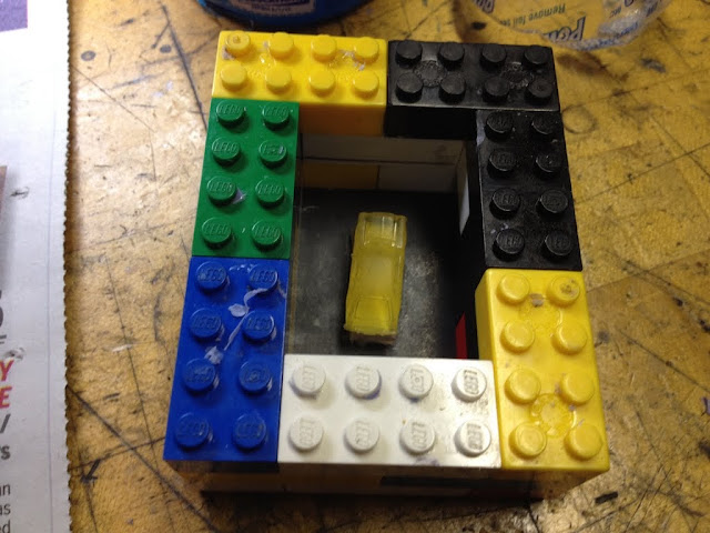

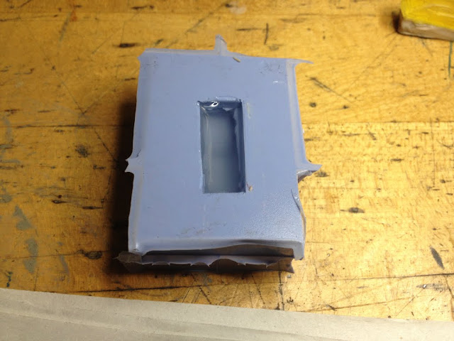

Plumcrazy, in the Railwire thread:Shrinkcasting HO scale vehicles to N scale.  Showed the technique Rasputen published in a Trainboard posting.
Hi Everone , I wanted to share some of my experience on shrinkcasting . I first read about shrinkcasting on this and other N scale forums . The best one I read was on Trainboard.com How to cast n scale vehicles from larger scale masters by rasputen . After I read rasputens Post I had to try my hand at shrinkcasting.
I have been shrinkcasting for a few months now ,and I have been getting good results
I start by making a silicon rubber mold of the vehicle I want to shrink to N scale . In this case an HO scale  Motomax Mercury Bobcat .
After the mold has cured it is ready for casting . I usually cast the Hydrospan in three different ratios of resin and water . I use two 2 ounce medical dispencers to measure the proper portion of resin and water ( I find Dram measurements work the best)
The first casting I use 1 part resin to 4 parts water the second casting 1 part resin to 4.5 parts water ,and the third casting 1 part resin to 5 parts water this gives me a better chance of getting closer to scale
Hydrospan cures very quickly so I use refridgerated water to slow down the curing it also has to be mixed thoroughly I mix it for about 20 seconds .This only gives you about 1 minute to pour in the mold .
when the Hydrospan mixture has set it has the color and the consistancey of a poached egg white . It can be removed from the mold in about a couple of minutes ,but you have to be careful ,because the casting is fragile . I set the castings aside to dry . I takes about 5 to 7 days to dry out and shrink to its final size
I measure the shrunk castings and pick the one that is closest to the N scale size of the vehicle (usually within .010 of an inch or closer)
I now make a silicon mold of the newly shrunk vehicle . After the mold cures you can start casting with resin to make the n scale model
The newly cast bobcat trimmed can be used as is ,or hollowed out and have windows added
I hope this post is helpful
Alex
