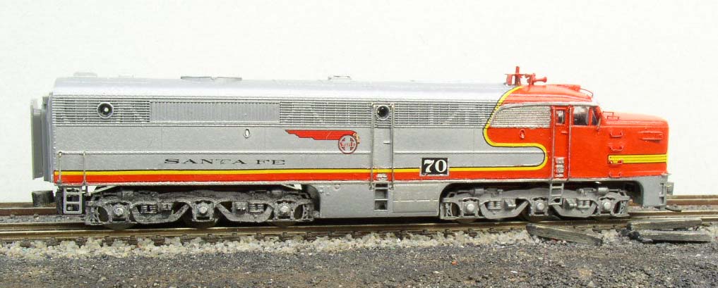

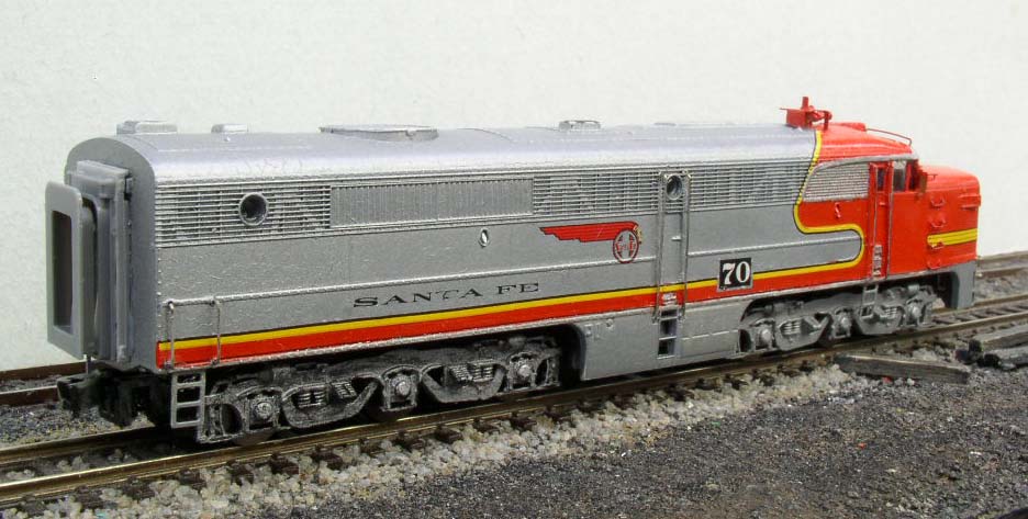

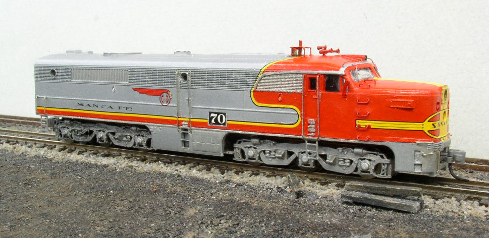

Seems like I've been working on this forever, finally have something to show for it.  Low-priority project, often pushed to the back here.
Luckily, Life-Like PA's are still pretty common, I wanted an ABBA set with a powered A and powered B and two dummies.   They powered units are absurdly powerful.
I ended up with a two powered A's, one dummy A, one dummy B.   I got a B-unit shell from Kato, and discovered that only the B units have coupler boxes on both ends, so I had to get a third dummy B.... oh well.   But for what I invested, I think I got both powered units for under $60, and the dummys for $20 each or under.    Pretty much four unit set for around $200.  I splurged and got a Richmond Controls mars and headlight set for the lead unit.
Alcohol on LL paint is easy and quick as a stripper, so road names were irrelevant.   LOTS of issues with wheel gauge, performance though, later.
There was an article in MR a few years back on detailing these for ATSF, that helped, and a lot of photos.   (Feb. 2005, yeah, I saved it)
So this is the 'pristine beauty' shots of dummy #70, the trailing unit of the four.   This one has the rather unique silver MT coupler, a nice feature that I'd saved from another project.
Now, on to the long list of changes and details....

Wow, where to start.
All handrails and grabs removed and replaced with wire.
Rear diaphragm junked and replaced with American Limited set
The odd number board casting above the windshield is now available from Shapeways.
Atlas/BLMA brass horns
Atlas/BLMA grabs on the RH side nose.
New headlight drilled in nose for proper ATSF headlight (top light is Mars light, not headlight)
Caboose hobbies short-shank dummy coupler on rear
GMM windshield wipers
My own etched brass mirrors
Note that I added the 'missing' windshield vent vertical post - a rather objectionable omission on the LL shell to me.
MT silver coupler on this one (lead unit got a Z coupler)
Holes cut in the nose for the MU plugs on both sides
GMM etched stainless steps on every unit
My own etched brass MU cables on low pilot
Radio antenna was an issue, because if anything wanted to be knocked off, that would be it.   I did it all out of brass, fabricated, and the antenna itself is brass wire drilled into the shell roof.   It's painted red now, but they were a grime magnet in photos.
This unit has an LED mounted in the headlight, but as the trailing unit, I can't imagine why I bothered.
I probably missed something.
Now, the paint...I masked off the nose, primed it and the stripes white, and reversed everything to do the stainless with rattle-can Testors metalizer stainless (yes, I still have a can!).   The red is testors Chevy Engine Red, which has the slight orange cast you see faded off the dark red.
The Micro-scale decals are just excellent, 60-72, still out there.   The only thing missing is the TINY black striping at the BOTTOM of the red stripe, they don't supply that and you have to get separate 1" black striping to apply.
I looked at how Con Cor, Life-Like, Kato and BLI painted theirs, and everybody missed something minor.   I probably did too, but getting it weathered here is the real challenge.
