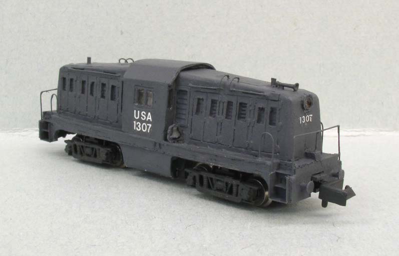

It's pure coincidence, but I just finished up a custom build of my Whitcomb 65-ton kit for a individual that wanted a model of the WWII era Whitcombs sent to Europe to run there during and following the African and European invasions.
It's kind of a forgotten achievement, but the 65-ton Whitcombs left Rochelle en masse, and some of they stayed in England, the Netherlands, and Italy post-war.   They were the 'diesel that did it' a long way from home in tight clearances, necessitating that sloped, low cab.
There are a couple of 'whaaa?' features here, yes, those are buffers, and yes, those are (by request) Rapido couplers to match all the other European equipment he has.   If you do a little research you'll see SN #1308 has a nice shot in Africa, and another was the first locomotive to enter Rome when Axis forces were driven out.
There are so loved in other places that the Lehigh Cement one was exported back to the Netherlands as part of a veterans memorial for WWII.  Here, the survivors that are still running are down to a very, very few, as the Buda 300hp engines were pretty much run until they failed.
EDIT:  Found the video:
The oddball design of these had some great military features, by the way.   The radiators were inboard to the cab, where they couldn't as easily be shot out.   And they were dual-engined, completely paired - two radiators, two generators, two engines - so that you literally could blow one end of it off and it could still run, at least in theory.  Putting the radiators by the cab would not be as good an idea in domestic service, as these were everywhere when they came back in War Surplus as industrial units.
There was a big batch of them that were on the dock in Baltimore at VE day, and Whitcomb apparently bought them back and converted that batch to the wider walkways and vertical cab sides for a little more room for the US buyers.  So you'll see the war-surplus slope sides, straight sides, and then the raised cab versions also used in various post-war configurations.

Wow what a neat little bit of history! Thanks for sharing all of that detail.
  (emphasis mine)
Nice job on the Whitcomb.
Does the emphasised also explain the different cab that was on the RS-1s/RSD-1s that went to Persia and Russia during that war (copies of which the Russians were building into the 1980s(?) )?

Yeah, anytime you see either an abnormally low cab or a sloped cab, you can pretty much conclude there's some military history there on a design that was intended to possibly go overseas and operate under European clearances.
It's not only diesels, it's steam, and sometimes, well, it just gets near-ugly as the cab gets pushed down.
https://www.ageofsteamroundhouse.org/army-2-8-0-no-612/
Texas State Railroad's 2-8-0 #300 (aka SPL 28) is also ex-military, WWI, but very similar.
https://en.wikipedia.org/wiki/Southern_Pine_Lumber_Co._28
But of all the wartime designs I've seen, I think the Whitcomb is the coolest, between both the sloped cab and the sloped sides.   That tight clearance came in handy when one of the very few operational survivors was the 'rescue' unit for the NYCTA subway lines, and is preserved and semi-operational at the Kingston Trolley Museum.  NYCTA kept her in good shape well beyond a normal service life.    She's still operational in May of 2021, if you love old stuff you have to see this.    Note that she runs just fine with one prime mover.
The only other one I'm aware of that's fairly original and quasi-operational is up on the WK&S, the "L&NE 602" and it's been a while since it's run.  There's video out there, but nothing recent.

  (emphasis mine)
Yep.
Like the Alco RSD1: https://en.wikipedia.org/wiki/ALCO_RSD-1
