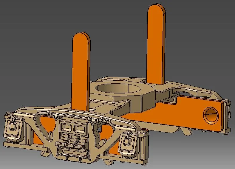

Here is a 3D rendition of a Fox truck Daniel (and I) could use on the B&M tenders.  It came from the B&M RR group on group.io site. The person who posted it also did the 3D drawing.  I suppose I could ask him if he would share his CAD file so you could modify it for electric pickups and N scale.
