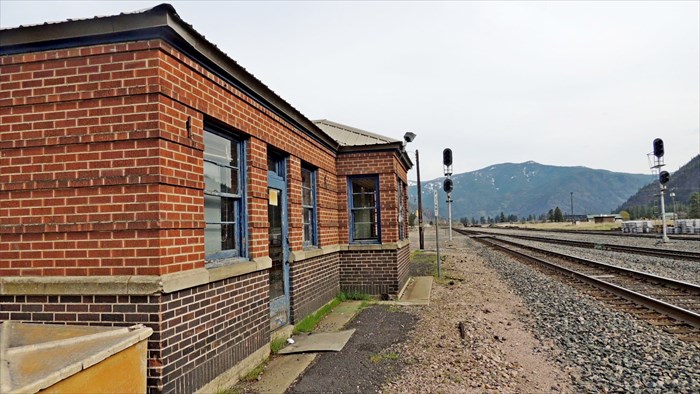

The pattern is actually Flemish Bond, where there are periodic rows of brick that are laid perpendicular to the usual running bond.
Would you know, what is the size/style/etc of this kind of brick (on the MRL's Paradise Depot):
