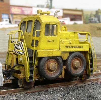

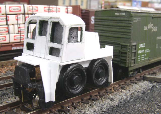

You'll have to go back to the Wayback machine on the Atlas forum, but remember that I used the original Kato 11-103 chassis to do my Trackmobile 14 years ago.
The problem was that it was really stiff.  But by replacing the 42" wheels with the 27" wheels from a Kato 11-105, and cutting the bejeesus out of the mechanism, I made a very workable Trackmobile.   I never could get it to pick up reliably, so I had to pair it with a four-wheel scale test car as a pickup truck to make it usable.   It's usable.
Now if this thing addressed the two major flaws - needed better slow speed and do something to equalize the pickup, I don't know for the life of me why you are laughing at this.   I'm not.  Mine runs very well but it could be better, probably enough for me to get one of these and see if my body shell can be adapted to it.
Now, this was scratchbuilt.   I'm not doing a kit.  If somebody wants to try this in Shapeways, have at it.   Just do yourself a huge favor and design the shell to fit this drive rather than perfectly scale the shell and try to jam the drive in later.
