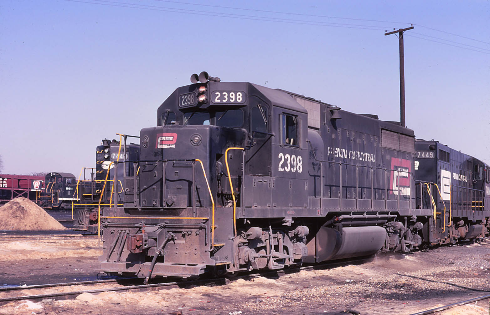

Atlas is currently offering two Penn Central GP35s - PC 2256 without a dynamic brake and PC 2263 with a dynamic brake and a red P.
I can't find any photographic evidence on the usual websites.
Are these two paint schemes fantasy schemes? Or very short lived schemes?

« Reply #2 on: June 16, 2020, 05:04:41 PM »
B&W but you can make out the red P.
The pictures of 2256 show a DB.

« Reply #4 on: June 17, 2020, 11:24:07 AM »
PC had non-dynamic GP35s (thank to the NYC's hubris about being "water level").
I'm assuming Atlas did their homework on numbers since they're usually pretty good about that.

The artwork in the catalog when they were announced had no dynamic brakes.

The production models both have dynamic brakes.  I am not sure why the artwork was done without dynamics (and I checked the file and the top down view shows the blister, go figure).  This  is the first that it was brought up and these were announced in January 2019!
