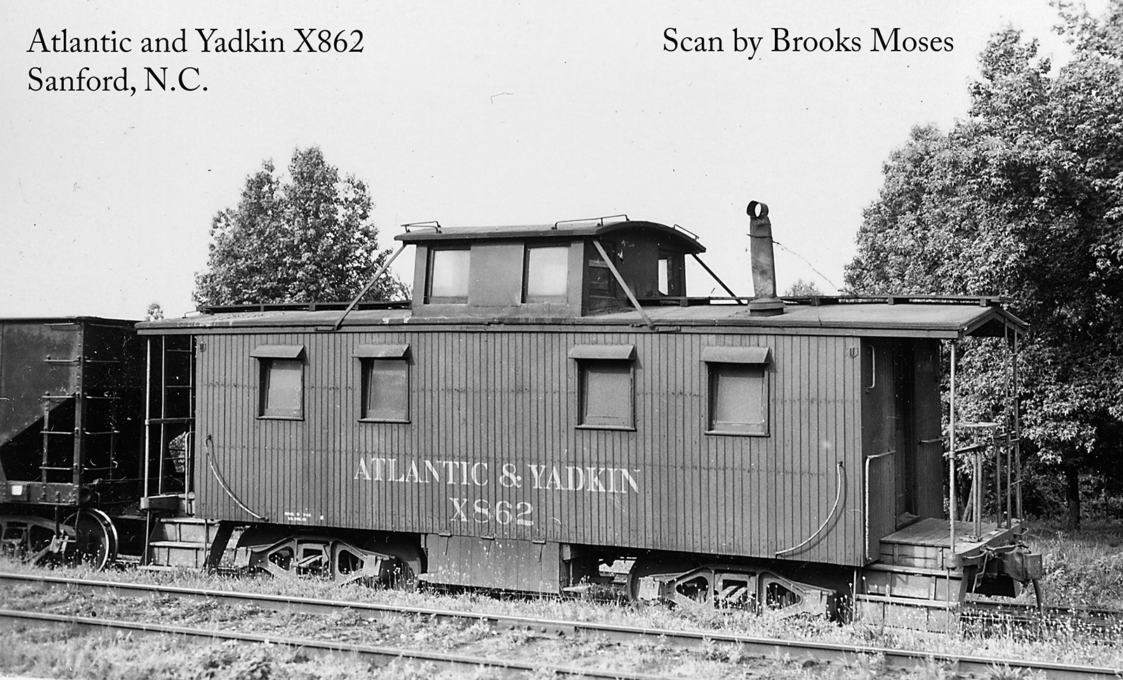

The 1930 date may be off, as maybe BC bought from a "dealer" such as "Railway Accessories" or"J. E. Skelton Co." as shown here.
http://www.trainweb.org/rf&p/roster/caboose.htm
Not shown on the roster is that at least one ended up on Atlantic and Yadkin (presumably bought from one of the "dealers"):
http://images.dpdx.net/2015-08-31-0003.jpg
Mark

@Mark5 I did some more hunting on that caboose and it turns out that railroad ended up with 2, #861 and #862. Still no actual source that specifically mentions that they are RF&P (even though it is obvious from photos.) The numbering is in the 800 series, but the RF&P never had a #861 and #862, so that eliminates confirmation based on keeping the RF&P's numbering. I found a J.G. Skelton equipment dealer from Richmond, VA from various Manufacturers Records on Google.
