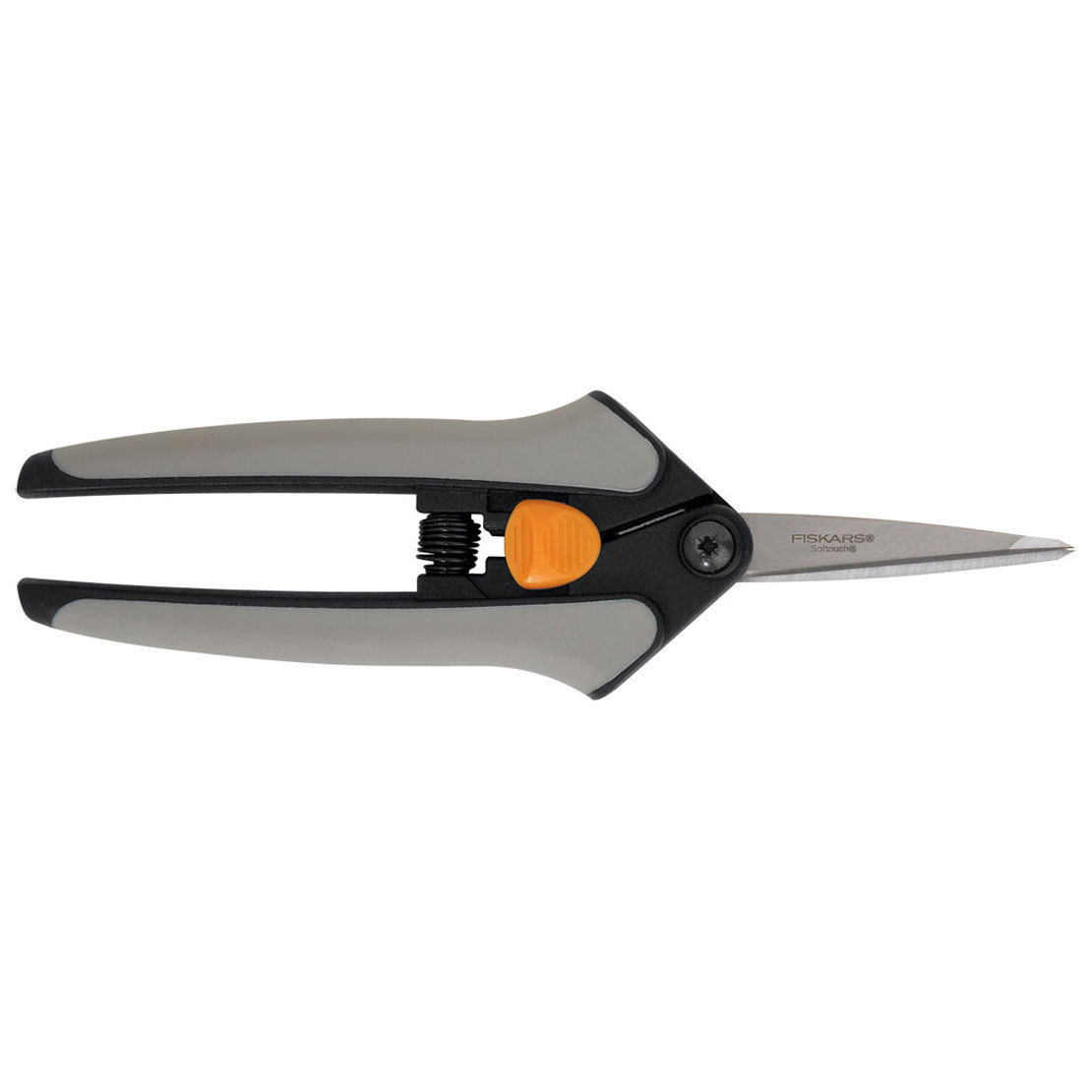

While searching through my parts containers, I found a printout of Ebit's improved LL SW electrical pickups.
He sent this to me years ago. He said he made his with phosphor bronze. The long finger gets bent
up at 90˚ to contact the frame. Held to sill with CA. I never tried this. How would you cut the phosphor
bronze?

A simple score with a sharp Xacto, then bend it back and forth till it breaks.
What do you have to cut?

I've got brass and phosphor bronze in sheet form. The latter is .005", if I typed that correctly.
 I have tried to cut with scissors, but it curls:(
