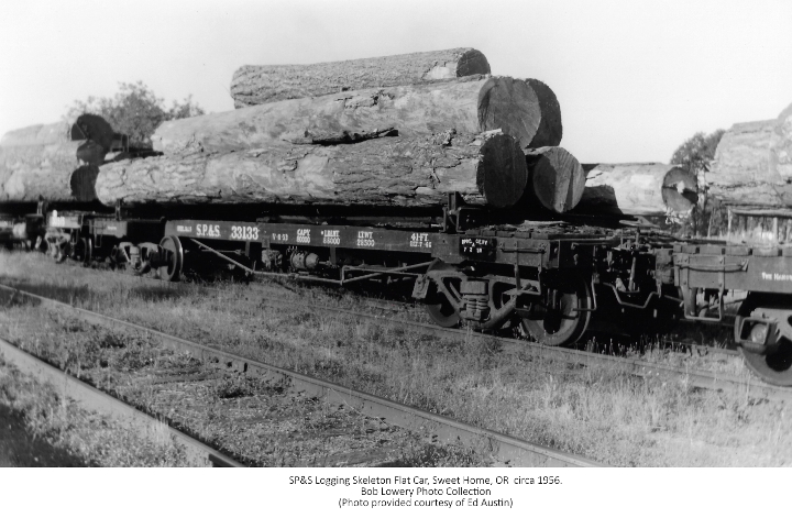

The prototype:

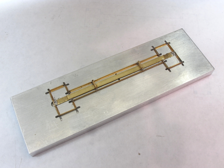

I machined this jig from a drawing I made, and then built the car frames by soldering 1.5 x 1.0mm L channel brass sections together.

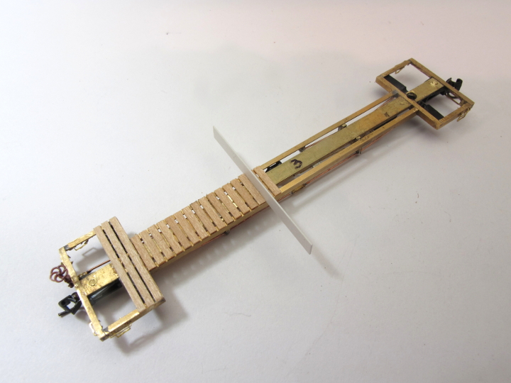

Scale 2" x 8" lumber (Northeastern Scale Lumber) cut and glued to the deck, using a .010" styrene strip to keep the spacing even.

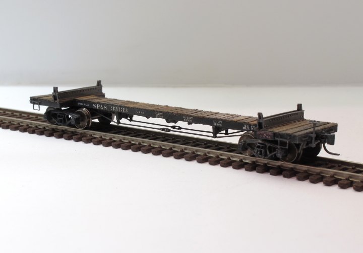

The finished car.  Decals are pieced together from here, there, and everyhere in by decals bin to get the prototype markings.

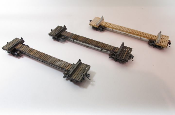

And now... my reason for making the jig... THREE finished cars.

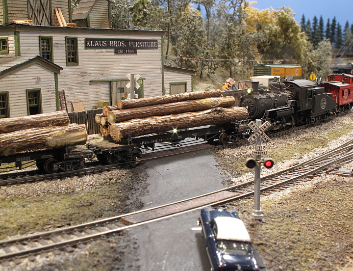

Happy times on the layout
