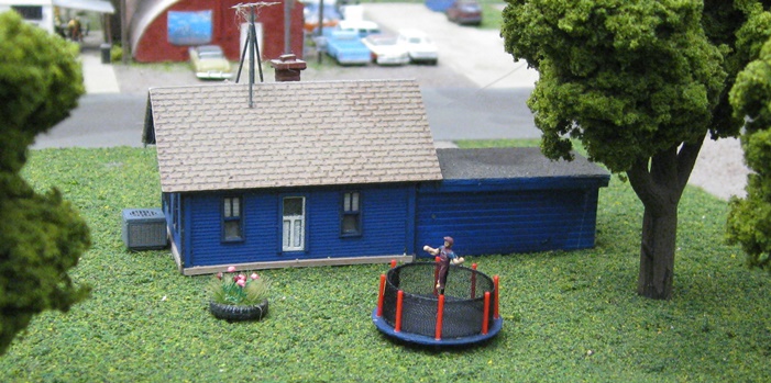

Anyhoo.... I've designed my layout for night scenes (IE, lots of lights), which has led me to purchase a lot of Woodland Scenics "Just Plug" lit cars to run up and down the Main Street of my town. Unfortunately, they're all a bunch of f'n antiques, which kind of makes my "ostensibly 21st century" layout look a little weird. But aha, I have come up with a workable solution!
Now I pretty much have carte blanche to put any sort of weirdo vehicle anywhere and everywhere I want  :)
As pictured above, my town does have a few other anachronisms beyond the cars, but for the most part it's modeled after a real/contemporary place (Hope, MN). As such, I've been doing my best to replicate all of the prototypical buildings there (along with their prototypical details). This occasionally leads me down some strange paths - like this week where I had to come up with a backyard trampoline, an antique plow, and a boneless lawn dolphin :P
That's all I got. Cheers!
