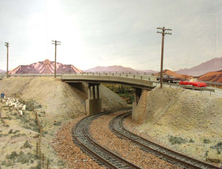

I think your bridge is just fine but if you're after a more 'interstate' look I'll show you what I did to mine.   Still a Rix bridge though.
I'm specifically modeling the 2-lane (new) overpass bridge at the west end of the Winslow yard.  It's on Google Earth.   Modern highway standards.
This is Rix piers, Rix deck, Rix underpinnings, and changing just the side guardrails/side supports with styrene and brass rod.   I used .060 thick styrene section, made a quick metal jig, and drilled a whole mess of .040x.040 square chunks for .020 K&S rod for the guardrails, then bent and glued those up.   Bent and sanded the shapes after it dried.   Works for me.   Mine's a little weird because it's curved to follow the backdrop right behind it.  Paint is Floquil Concrete with chalk weathering.    There's also a front-surface mirror in this shot, see if you can find it.
