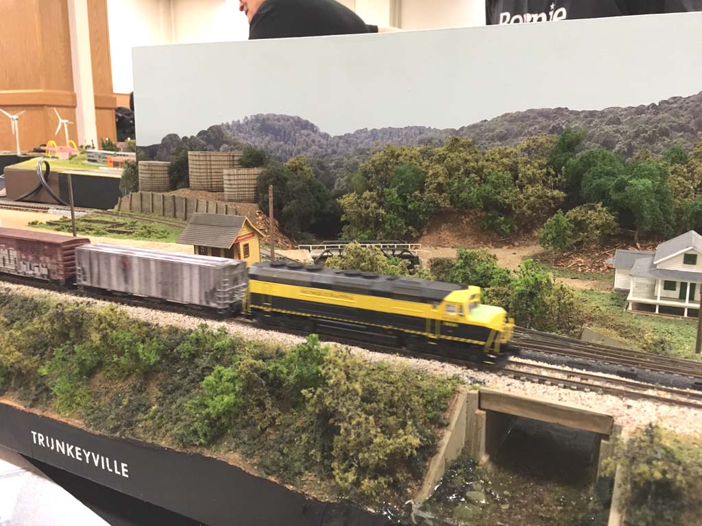

A long time ago I stumbled into a backdrop theory where you paint the sky area and build the backdrop kind of like a collage with various photo and commercial elements in it, rather than looking for that 'single perfect' backdrop image that never exists.   It looks like the way your're going too and I think its very effective.    Really looking forward to seeing this in person.
Way back in 1976 I developed the Hickory Valley portable layout with 10" backdrop so that it was easier to move and crate up.   As I've done T-trak modules I've done the same 'standard'.   I've got two sets of T-trak modules, Hickory Bridge and Thompson, that are triples and flip over top of each other for transporting as a sealed crate.   The doubles, Trunkeyville and Jamison, are built the same way.   It works with the permanent, 10" backdrop boards.   They are still removable, but I never take them off and the scenery is blended right into them.
http://www.randgust.com/TRKMOD023.jpg
One trick with that is to develop end pieces of the crate with handles, and also a 'rib' of 1x1 pine across the top inside edge so that you bolt the end pieces on, then flip the second module upside down and reversed as the lid for the first part - but it has to have something solid to rest on while you put the bolts through the top of the end pieces to make it a solid unit.   About the first time you drop the top module on the bottom module you'll come up with this idea on your own....
I've now got 2 portable logging railroad modules and 5 T-trak modules, working on a sixth....so figuring out how to move them and fit them is a 'whole different challenge'.
