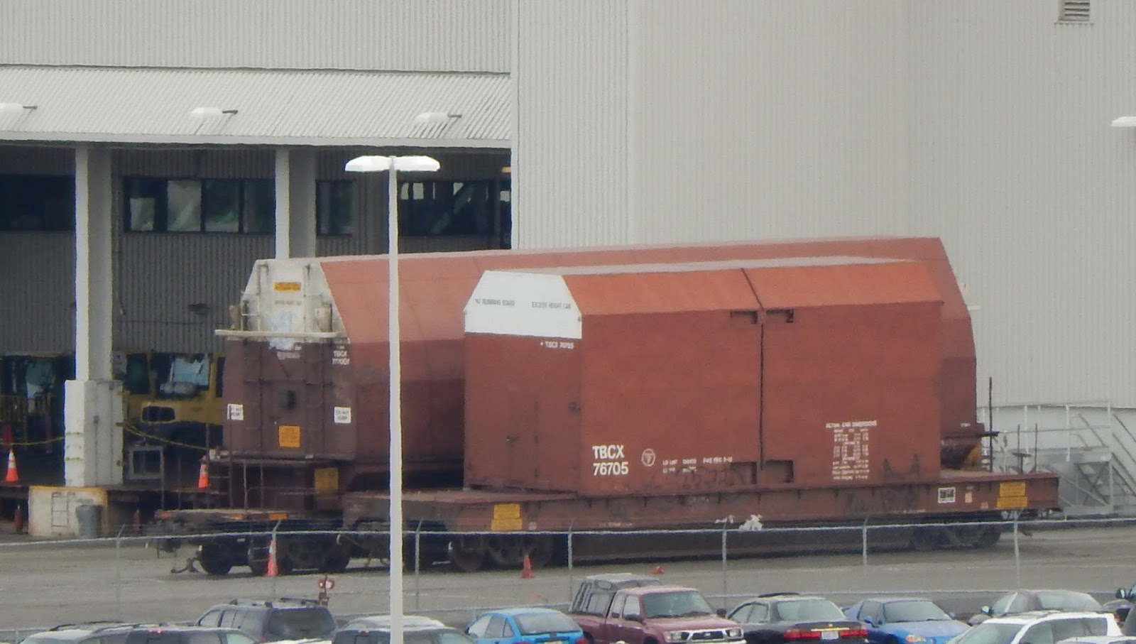

Anybody have any idea what this box is?
http://s3.amazonaws.com/rrpa_photos/55642/1e%2004-19-2010%20Seattle%20040.jpg
It appears to be collapsible when loaded.  I can only guess there are mounting parts that stay with the flatcar, which are stored in the erect box when the fuselage is unloaded.
You are correct, the collapsible box is for shipping the various mounting components back with the empty car. This photo appears to be taken just outside and to the east of the Renton plant where empties are sometimes left between the trains bringing loads (47.501020, -122.198918). They never leave the loaded cars outside the plant likely to avoid any potential vandalism, there are extra storage tracks inside the plant (47.496798, -122.207266 & 47.496616, -122.211111)
