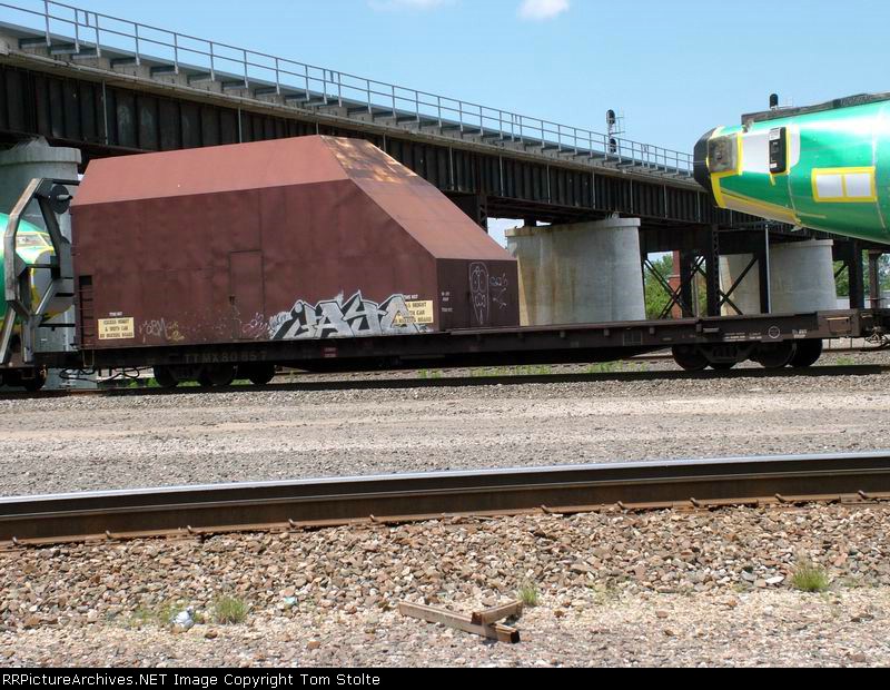

I'm starting to wonder if the rear break wheel is only on the Skybox style, which has doors on the opposite end, and not the angled component box which only has rear doors.
I saw the platforms and box thing, which looks less like a toolbox on closer look.  Any ideas what that may be?
Although several previously constructed HO models were seemingly fitted with component box mounted brake-wheels, thinking I am going to have to review the dozens of BNSF Boeing train videos that have been downloaded over the years to get us some answers on the proper brake-wheel location.
Judging from its size, like "smart" EOTs, the box might house electronic equipment for monitoring air brake pressure and providing radio transmitted telemetry that includes rear end car movement.
There are a few things that immediately became apparent in your screen-shots:
1, The yellow "Excess Height" placards on the sides of the component box have completely faded to white.
2. Though the white door lettering is clearly visible, the white paint and the black "Excess Height" text is completely worn off the areas above the doors.
While the ones on the component box are longer and do not appear to have perforation holes, the platforms are similar to those that are found on the Intermountain PS 5277 Cubic Foot Boxcars.
Are you planning on adding cut levers to your models?

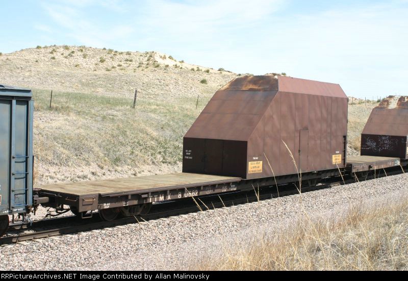

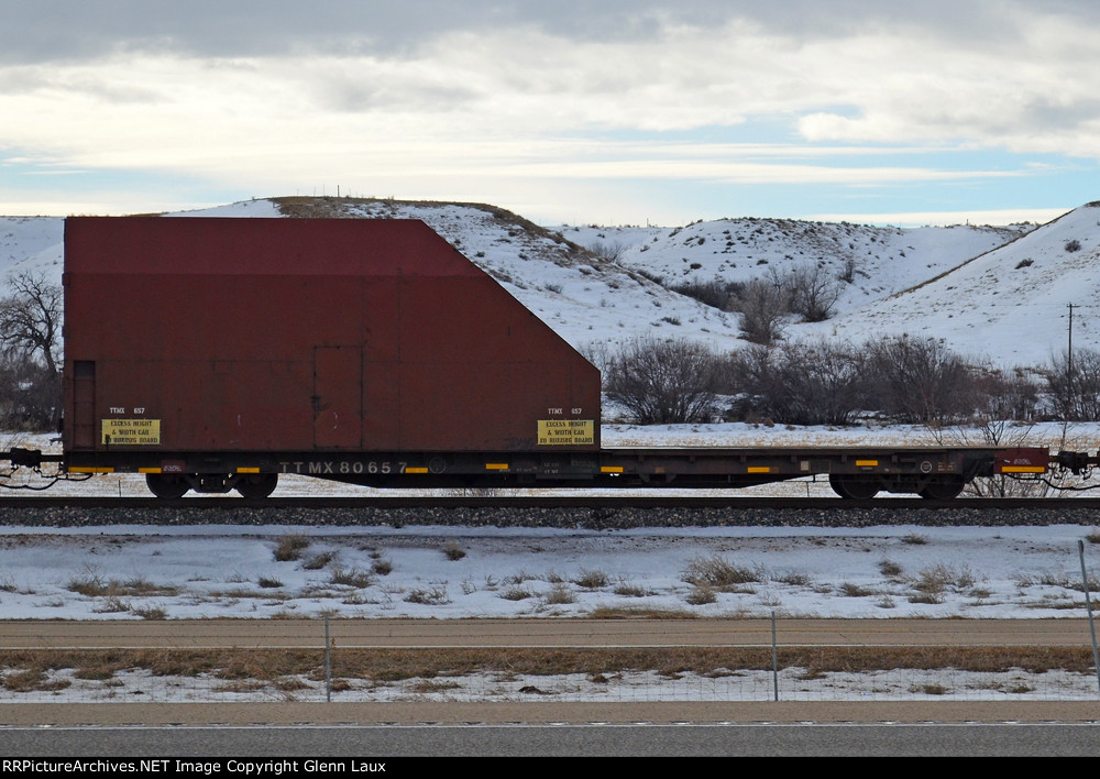

Here's TTMX at two different times.
In 2006 it had a regular drop style brake wheel where the floor would be cut in a semi circle to allow the wheel to go flush.
Then in 2014 the same car which I believe show the lever style brake handle.
Here's a different car in 2006 with the brake wheel dropped.
  • Posts: 8956
  • Respect: +1392
Re: Detailing the Micro-Trains BNSF Fuselage Set
« Reply #78 on: August 15, 2017, 03:00:51 PM »
Here's a screen grab that show the level brake pretty well.
